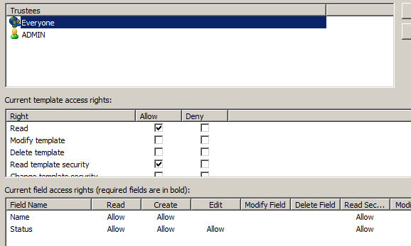

My customer requires that one template field is made read only.  I can do this through template security.  Here I have made the Name field read only:

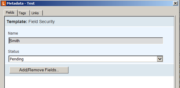

The template looks like this:
The Name field is now read only; all good so far.
But you will also notice that the user can no longer change the Template.  My customer has to be able to change the template.
Is this normal Laserfiche function or have I missed a setting?  Please confirm.

I can confirm that this is expected behavior.
The logic behind the system preventing template change is that changing the template discards the field values from the old template, and removing a value also qualifies as a change to that value.  Thus, if you cannot write to all of the fields in the template, you're not allowed to change the template.
