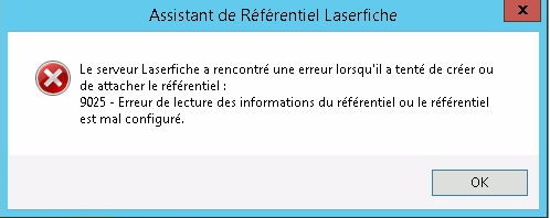

I'm trying to create a repository but I can't.
At the end, I have an error.
The Laserfiche server encountered an error while attempting to create or attach the repository:
9025 - Error reading repository information or repository is misconfigured.

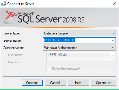

Hi Scott,
Thank you for your return. I'm not pretty good with SSMS.
You said to run the code above for whatever my service account's name is ; i'm not really understand. Do I just need to run the code or do I need to change "LaserficheServiceLogin" by something?

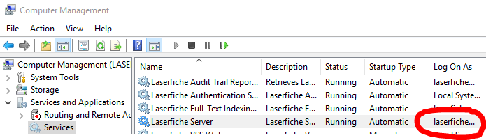

No, that's your personal login. You need the service account:
