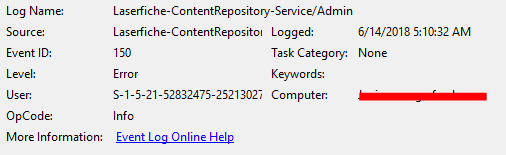

Hello,
Just wondering if anyone has came across this error in the past and can shed some light on what exactly it may be referring to. Screenshot attached and error copied below :)
The description for Event ID 150 from source Laserfiche-ContentRepository-Service cannot be found. Either the component that raises this event is not installed on your local computer or the installation is corrupted. You can install or repair the component on the local computer.
If the event originated on another computer, the display information had to be saved with the event.
The following information was included with the event:
-1
0
CatalogManager::BkgrIndexRequestSender
[Microsoft][ODBC Driver 11 for SQL Server]TCP Provider: A connection attempt failed because the connected party did not properly respond after a period of time, or established connection failed because connected host has failed to respond.
select * from (select top 100000 time_stamp, tocid, type, mid from index_queue where time_stamp > :time_stamp<bigint>  order by time_stamp) t order by time_stamp desc
08S01

The LF server encountered a problem connecting to the SQL server. This is happening while performing the full-text index. Can you sign in to the repository? Is the full-text search engine working correctly?
replied on June 18, 2018
I had the client confirm and she stated all good to go with indexing. This was a one-time error after windows patching occurred that we were curious about. Thanks for clarifying for us!
