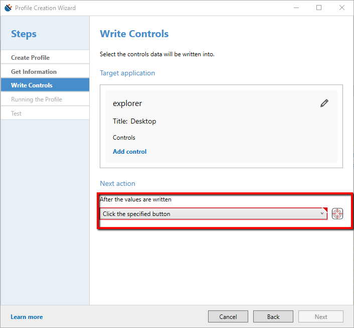

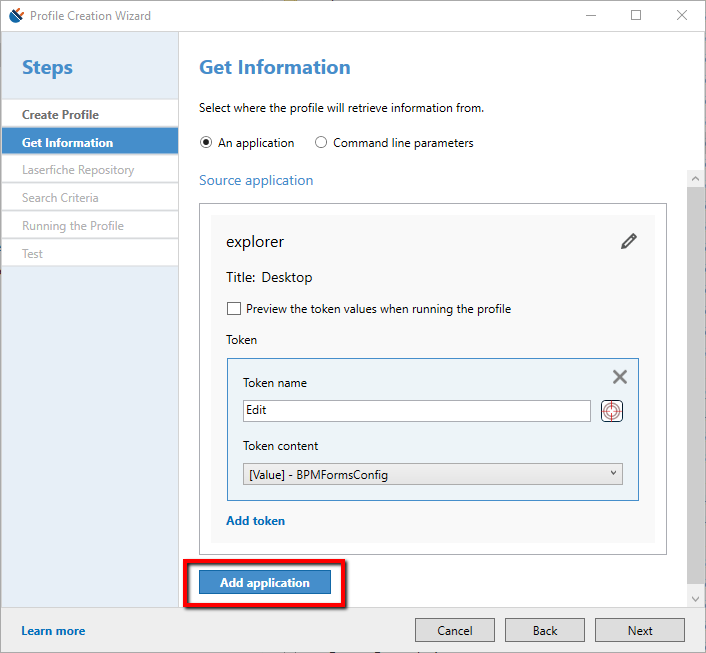

You can refer here to combine actions. You can add application for each tab in "Get Information" wizard, then Connector will find the field.
You should add action to switch tabs to gather all data from different tabs. You need to create another profile that in "Write data to an application" action. The action has "Click the specified button" in "Write Controls" wizard.
After two profiles are created, you can refer document to combine actions you want.

replied on June 26, 2018
My approach can only resolve the fixed number of the tabs. If the tab number is variable, Connector cannot handle it.
