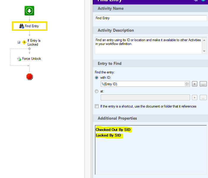

As Miruna said, you can cancel a check out through the client, but UndoCheckOut is not the same kind of function.
The code I provided is more similar to what is happening behind the scenes when you cancel a check out through the admin console.

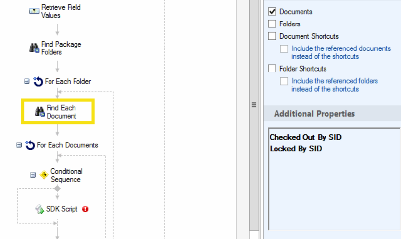

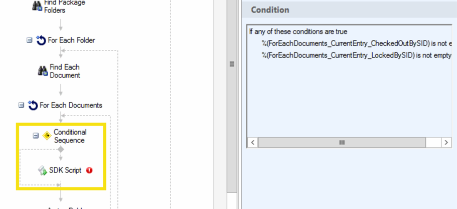

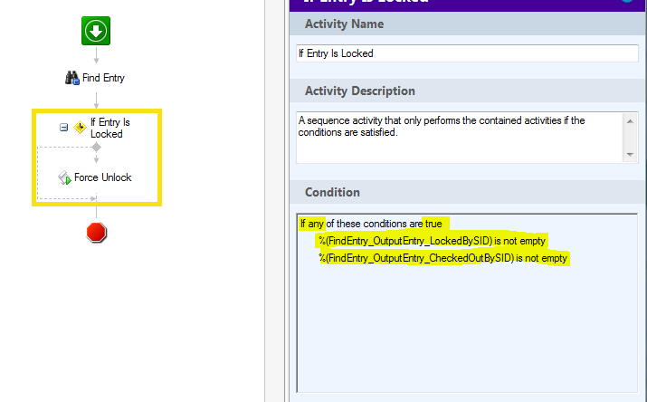

As for checking whether or not something is checked out, the Find Entry activity allows you to get the "Checked Out By" and "Locked By" or ("Checked Out By SID" and "Locked By SID") properties of the document.
If either of those is not empty, then it is safe to assume the document is checked out, and if you want to get more specific you can use the SID versions to create an identity object and only retrieve a list of locks associated with that user.
For Example, the following uses the CheckedOutBySID and LockedBySID value(s) obtained from a Find Entry activity and unlocks the document if it is checked out or locked.

replied on December 8, 2020
Jason,
I know this is an old post, but it's exactly what I need in my current situation, and I'm hoping you can assist me in implementing it.  I used the code in your last reply, and set up the Find Entries and conditional sequence just as you did, but I'm getting the following error:
 Error    1    The type or namespace name 'IdentityReference' could not be found (are you missing a using directive or an assembly reference?)
I'm not great at coding, so I'm just assuming that I'm missing something from another part of your code where it references the ID of the current entry?  I don't see anywhere in this snippet where it does that, so I assume that's what I'm missing.  Could you help me figure out if that's the case?
Here's my code:
// Create array containing each lock type
string[] lockTypes = new string[] { "CheckedOut", "Locked" };
foreach(string lockType in lockTypes){
    // Get identity token object
    var identityToken = GetTokenValue("ForEachDocuments_CurrentEntry_" + lockType + "BySID");
    // Check if entry is locked
    if(identityToken.ToString() != ""){
        // Get Identity Reference
        IdentityReference identity = identityToken as IdentityReference;
        // Initialize lock list settings only for the target account
        EntryLockListingSettings lockListSettings = new EntryLockListingSettings();
        lockListSettings.IdentityReference = identity;
        lockListSettings.PersistentLocksOnly = false;
        lockListSettings.SortColumn = PersistentLockColumn.CreationTime;
        lockListSettings.SortDirection = SortDirection.Ascending;
        // Get the lock listings
        EntryLockListing lockListing = EntryLockListing.GetListing(0,lockListSettings,RASession);
        // Iterate through the list to find the target entries
        foreach(EntryLockListingRow row in lockListing){
            // If current entry matches target entry
            if(row.EntryId == this.BoundEntryId){
                // Unlock the entry
                Entry.Unlock(row.EntryId,row.LockToken,RASession);
Thanks in advance!

replied on August 28, 2024
I apologize again for another tag onto this old post, but it seems as though it is what I am after. We occasionally have errant locks, rather locks that give a warning to the user that it is locked, but nothing showing in the admin console. However, the document properties show a user account in "checked out by." We log in as that user check out and either undo or re check in the document to clear the lock error.
I am hoping to implement a business process that gives a couple admins the ability to remove these error locks without having to give them other users' credentials. However, it does seem that if the script is executed while the user has the document open, they then save and close that document it now marks it as checked out:
running the script again will not clear this value. Additionally, if a user has this checked out, and we run the script, it clears the appearance of a lock, but the item still shows that user as having checked out the document. Ultimately I just need something that completely clears the lock and any values that may hang up a document. Any ideas?

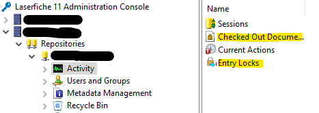

replied on August 29, 2024 • Show version history
@████████ Just confirm, when you say there are no locks in the admin console, are you clearing both Entry Locks and Checked Out Documents? I've never seen the exact scenario you're describing, so I'm not too sure.
Although related, locks and checkouts are separate things; locks can apply to all entries but check outs are for documents with version control. I have not used a script like this to force unlock version-controlled documents before.
In the SDK there are check in/out related methods for DocumentInfo objects, but EntryInfo objects only have the lock/unlock methods; however, those methods are for the current user context not undoing other user checkouts.
The user saving would still be a problem since they'll already have the document open, so you might also have to disconnect their Session.
