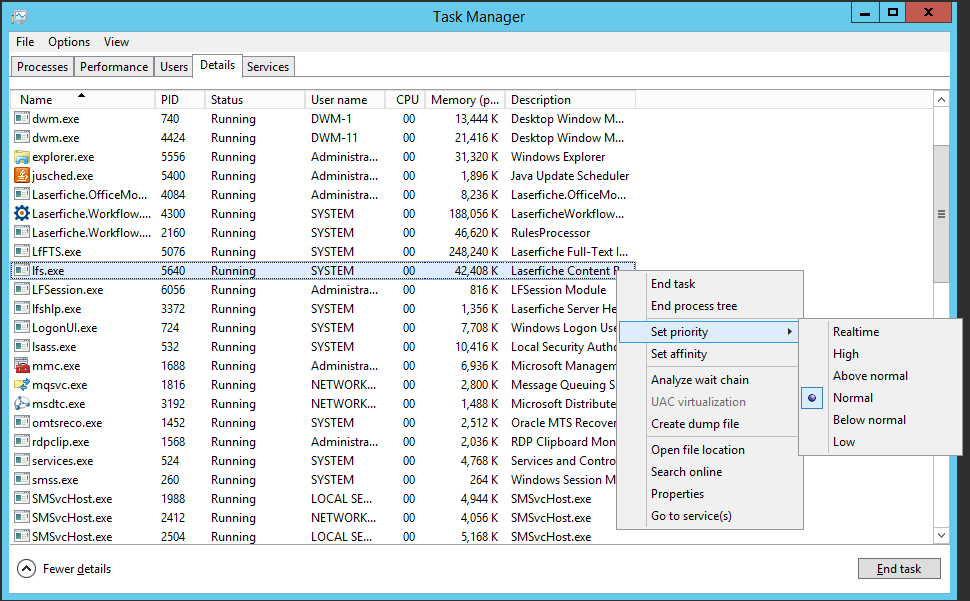

Hola Adarsh, además a lo que señala Qinmei,
Te sujiero priorizar los procesos en el sistema operativo del servidor, por ejemplo el Laserfiche y Workflow podrían estar sobre el Importagent.
Sospecho que entre el Importagent y el Workflow bloquean un mismo documento el cual genera una contención del proceso.
Suerte.
Copio imagen donde puedes alterar la prioridad de los procesos.
Hello Adarsh, in addition to what Qinmei points out,
I would prefer to prioritize the processes in the server operating system, for example the Laserfiche and Workflow could be on the Importagent.
I suspect that between the Importagent and the Workflow they block the same document which generates a containment of the process.
Luck.
Copy image where you can alter the priority of the processes.
replied on June 16, 2018
Hi Manuel,
Thanks for your response. This looks straight forward, might give it a try.
I had tried this for a different application some time ago but didn’t have much success so it never occurred to me to try this.
Have you made this change to Import Agent and seen it’s effect? I’m not doubting but just wondering if you ran into a similar experience and this minor modification permanently resolved the issue.

replied on June 18, 2018
Hola Adarsh,
Te comento que nosotros contamos con varios servidores virtuales y en cada uno de ellos  se ejecuta un servicio de Laserfiche,  bajo este modelo de procesamiento es que ponderamos la carga de los CPUs. Tiempo atrás teníamos todos los servicios de Laserfiche en un solo servidor y para lo cual utilizamos el método que te comenté (priorización de los tareas en el servidor) y mejoro el rendimiento.
Thanks Manuel.
I feel more confident about making this change now. I also installed an update as suggested by Qinmei, it has definitely had a positive impact. We scanned 1500 documents in a span of 10-12 minutes, it ran as expected.
I will change the CPU priority after further monitoring the performance of the system.
