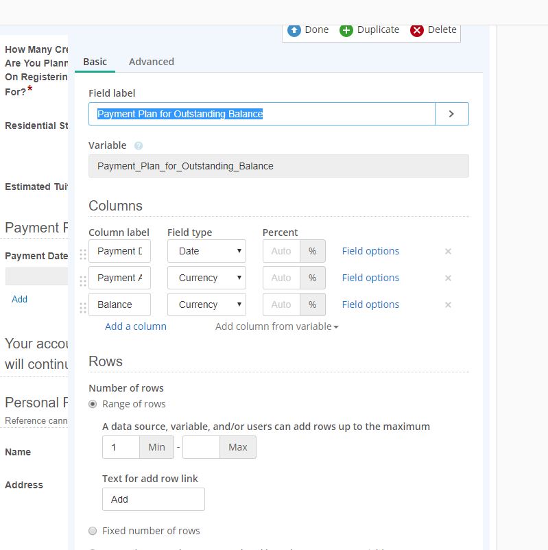

We are working on a student late payment balance payment agreement form and cannot get the calculations to work. I can't find a place where it teaches us where to use what kind of formula's that are specific to this. We have a table set up with three fields and on the Columns Advanced area we have this formula on the Balance.
=SUB(Total_Unpaid_Balance_Outstanding, Payment_Plan_for_Outstanding_Balance.Payment_Amount)
But it's not actually calculating, it states there is a calculation error. All of the formula's we've found have a least one static number in them, not two variables that need to add and/or subtract. When we insert static numbers instead of variables the calculations tend to work. Is there a better formula for getting a calculation with variables?

I'm fairly new to Laserfiche but I have come across a similar issue to yours.  I found that you have to index the table and row where the first value is if it is not part of the table you are working with.  In your formula, you have "Payment_Plan_for_Outstanding_Balance.Payment_Amount" in that table, but "Total_Unpaid_Balance_Outstanding" seems to be elsewhere.  If this is the case, try using:
=SUB(INDEX(Total_Unpaid_Balance_Outstanding, ROW()), Payment_Plan_for_Outstanding_Balance.Payment_Amount)
