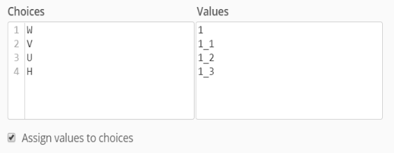

I wondering if it's possible through javascript or otherwise to have a drop down in a table where all of the values in it can equal 1? The use case is to get the sum of all selections of the same kind tabulated to  respective fields. All selections are only worth 1 so that each can be calculated properly since each value equals a day.
So far my experience is that the values need to be unique to calculate properly using the functions on the advanced tab. If I make all values set to 1, then Forms versions it like in the screen shot.
I'm really interested to see if there's a way for javascript to handle this use case.

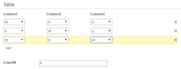

This is just bugging me now, I tried setting up the COUNTIF as a test as you had stated and it's not working either, so I came up with a work around. Instead of COUNTIF, I used SUMIF to count the W's in the Table. For each of the Drop Down Options, I gave them a numeric value
I then used the following formula to SUM the W Values which is "1" by Column
=SUM(SUMIF(Table.Column1,"1"),SUMIF(Table.Column2,"1"),SUMIF(Table.Column3,"1"))
There is likely a better way for this but I basically handle each column individually at this time. The Picture below shows the results when I made the W selections in the table.
