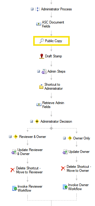

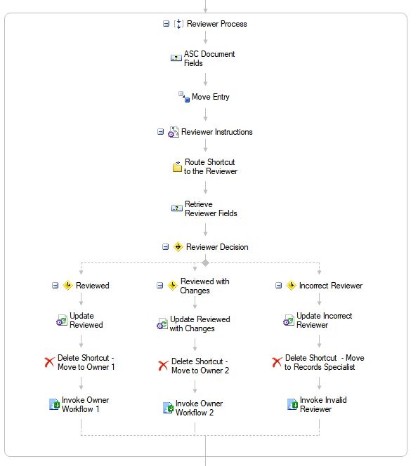

So it starts with an Administrator selecting the appropriate person to review. It then goes to the person whom they have selected. If the Administrator makes an error. I would like for it to loop back to the Administrator by the reviewer selecting "Incorrect Reviewer".
Like in Forms we can have something in a repeated loop until a condition is met.
Invoking a workflow I can have the steps separated out. So the administrator would finish their process then invoke the reviewer process. If it is the incorrect reviewer it would follow that conditional path and invoke the administrator workflow again.
