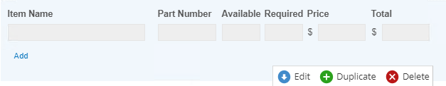

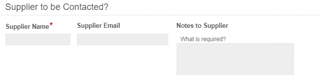

We have a client request where they are emailing from LF Forms. What they would like to do is the following:
1. Be able to select Items (multiple lines as per below)
2. From there select the suppliers they need contacts (multiple suppliers can be selected as per below)
3. From the parts list, be able to select which lines go to a specific Supplier.
For example, There are 4 lines with parts required, and they would like line 2+3 to go to supplier 1 and lines 1+4 to go to supplier 2?
I was thinking if I add an additional field within the field Table with incremental numbers as in 1, 2, 3 etc. Then the user specifies the number in the second table where the supplier is contacted. Would that work? I would then use LF Workflow to match the rows and populate the email and send?

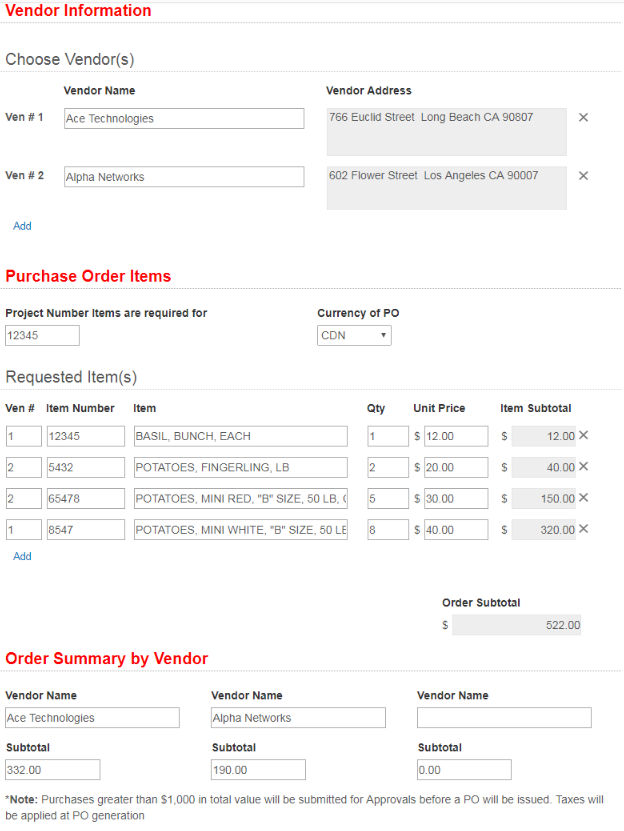

replied on June 1, 2018
Hi Ziad

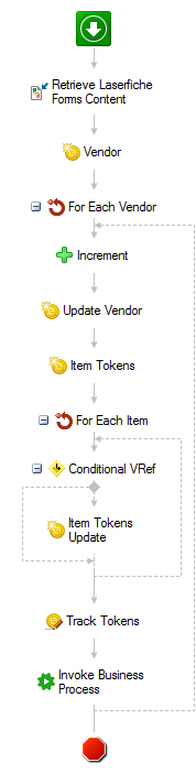

I had built a demo along that root, see picture below, one part of the form they defined the Vendors and then they assigned the displayed Vendor Number to the associated Row. From this I was able to subtotal each vendor and generated the PO's for each Vendor, I didn't have the email piece that would have been an easy add-on. In my process I ended up Generating a New PO form for review which could have been emailed, or I could have used a Mail Merge to generate the document and then email. Workflow layout Below

replied on June 3, 2018
Thanks Steve,
That looks like a great solution to start, question i would like to add to this which is an extra,
Say I wanted Supplier 1 to have parts 1 + 4, but also wanted Supplier 2 to have parts 2, 3 and 4 for example, how would that be added? Would I just have to add another line for the parts and set the supplier number so it is included?
Thanks
Ziad
replied on June 4, 2018
Hi Ziad
That seems like an unusual use case, but if you wanted to go that way it would likely be far easier to add additional line items for those parts.
Thanks Steve,
We usually deal with the unusual. But, I think extra line items will help and be easier than to try anything different,
Regards
Ziad
Where in the form in your screenshots does the user indicate which lines need to go to which supplier? Is it always 1+4 and 2+3? Why wouldn't they pick the supplier first and then indicate which parts they want from this supplier?
Hi Miruna,
I have not added that field yet, but that is what i am leaning towards, it can be different every time a form is submitted. So it can be different selections for different suppliers. I have it at the moment with parts first then to specify the suppliers needed for those parts.
Hope this helps
Ziad
