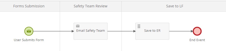

I have the simplest form in the world (see attached - seriously could not get any simpler!!). I upgraded to 10.3.1 & now I can't save my form to the repository. I get this message which seems to be coming from the final step of the business process:
