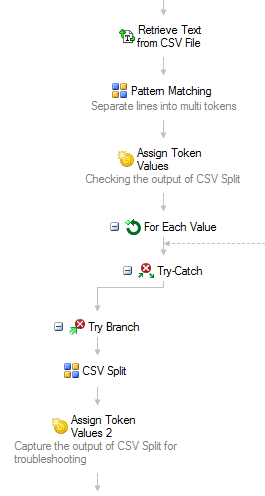

Here's the Workflow:

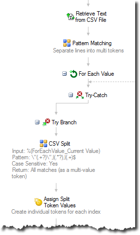

And here's the structure of the pattern matching activity for CSV split:

For anyone else needing to do this, here's the outcome.  I went with Andrew's suggestion, and although Ben's regex worked as well, Andrew's second regex removed the quotes from the Department result which was handy.  Here's the final workflow:
And here's the setup of the "Assign Split Token Values" token:
Thanks again guys!
