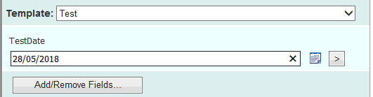

In Client there is a date field in Short Date format.

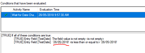

Test 1)  If the date already exists before the workflow is run, the condition matches.
That is the field already contained a date in AU format:

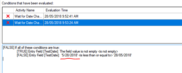

Test 2)  If there is no existing date, then workflow will wait for a date to be entered.
When the user enters a date (in AU format) the workflow does not accept the condition because the date appears in workflow in US format MM/dd/yyy.
So the difference is:  If the date exists, workflow sees it as AU format.  If the date is entered during a Wait for Entry Change, workflow sees it as US format.

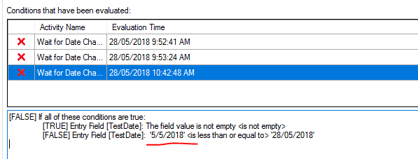

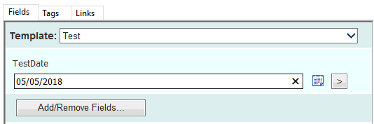

I have also found the following:
If I enter the date as 05/05/2018, workflow still does not recognise the date as valid:
Workflow shows FALSE even though the date appears correct.
