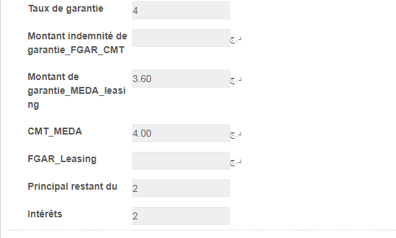

hi everybody,
I have a form taht contains 4 formulas (the four currency fields). two of them are working, but not the others.
i tried everything but can't find out the problem.
the two formulas that are not workin "Montant indemnité FGAR_CMT" and "fgar leasing"
use the same variable "taux de garantie" but its a number field that contains "4" so it it cant be the problem.
And it doesn't display anything, neither the result nor an error.not even 0.
any suggestions?

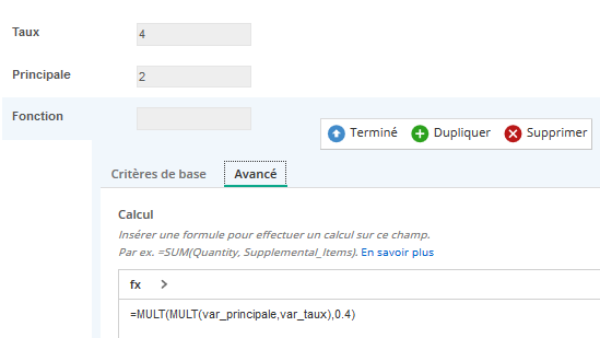

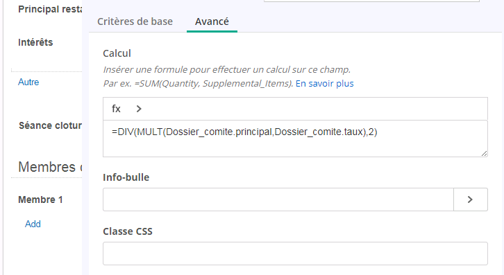

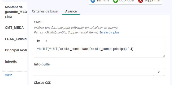

replied on May 29, 2018
hi olivier, thanks for the answer
the two formulas are on the pics .
 Montant indemnité FGAR_CMT = "MULT( MULT( Dossier_comité.taux,Dossier_comite.principal),0.4)
Regards

this works if the fields are not in collection.. Try it using fields contained in the collection.. As I suggested earlier Hanane you should try using the PRODUCT() as it works for me..
replied on May 30, 2018
hi guys,
Product works! i'm so happy, i can't' believe it works! have been workin on it for almost two weeks ! and I'm afraid of being disappointed. i tried it on my VM, but  not yet on the client preprod server.
