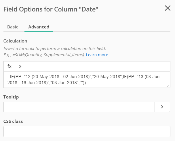

Hi there,
I'm working on a form for our staff to submit timesheets and I've figured out how to populate one date with a nested =IF( statement so that I can at least get one date to populate depending on the pay period that staff select (the form will have to be updated annually to fix the PP for next year). I was hoping to populate the dates for the rest of the table. Is this possible? I've included a screenshot of the table in the form below and the nested =IF( statement for reference. Thoughts?

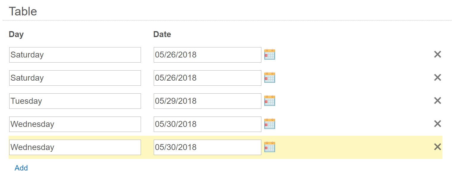

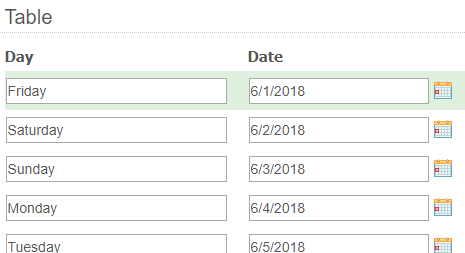

replied on May 25, 2018 • Show version history
Hi,
Try using the code below. I used an external library called moment.js and it seems to work.
A few things to keep in mind.
1. I set the first column for holding the "Day" and the second column for holding the "Date".
2. The code runs whenever a change is made to the table. This is probably not the optimal approach but I set it this way because I don't have a complete understanding of how your Form is set up.
3. I am assuming that you only have one table. If there is more than one, you need to be more specific with the the selector: $('table.cf-table') since this selector applies to any Forms table.
4. The format for my date column is set to MM/dd/yyyy. I'm not sure if this matters but just a FYI.
$(document).ready(function(){
  $.getScript('https://cdnjs.cloudflare.com/ajax/libs/moment.js/2.22.1/moment.js',function(){
    $('table.cf-table').on('change',function(){
    	var numrows = $('table.cf-table tr').length;
      	for(i=1; i<=numrows;i++){
        	var daycol = $('table.cf-table tr').eq(i).find('td input').eq(0);
        	var dt = $('table.cf-table tr').eq(i).find('td input').eq(1).val();
          	$(daycol).val(moment(dt).format('dddd'));
PS: I am interested to know how everyone would optimize the code so please feel free to comment if anyone has suggestions.

replied on May 26, 2018 • Show version history
In this case, the code is doing the following:
1. Iterate through each rows of the table
2. For each row, grab the second column value (the dates)
3. Convert that value into day
4. Populate the value from step 3 into the first column of the same row
The library contains some complex logic that allows you to convert dates into different formats such as day. Because it doesn't have a hard-coded list that maps dates into days, it's very flexible; you can get the day from any date of the year so you shouldn't have to manually update the form on an annual basis.
Also, just to clarify, your variable definition or class definition doesn't really matter with the code above since it's just manipulating the first and second column values.
Try copying the above code into the JavaScript section of your Form. If that doesn't work, I am open to doing a quick remote session. It shouldn't take more than 10 minutes to figure it out.

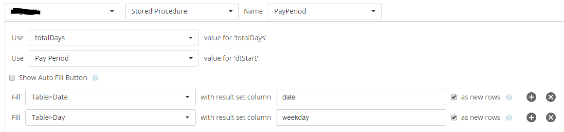

replied on May 29, 2018
Hi Emily,
The stored procedure (SP) would need to be configured in your database.   You would need to get with your DBA to set it up.  Stored procedures are common and would only take a minute to create.   Once it is setup, you would add (or refresh) your forms data source that referenced it so that it is available to your form in the Lookup Rules.

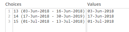

To use the SP to populate the table days and dates you need nothing more than 2 fields on your form (no classes or other calculations).   One of which you already have,  your pay period drop down.   The other field you would need is a numeric indicating how many days of data to return.   This could be a hidden field on your form that is set to 14 days or  if you are always returning 14 days,  that could be hard coded into the stored procedure and you would only need your pay period drop down.
If you configure the pay period drop down so that it has a value assigned, the pay period start date, that value can be sent to the SP as the starting date ....
Using a lookup rule:
The SP I posted is dependent on Microsoft SQL Server database since it references an internal table.  If you are using Oracle it will need a tweak.   The internal table is, master.dbo.spt_values, and all it does is return a list of numbers, 0,1,2,3 ....  used to increment the date.   No other tables required.
Usually more than one way to do things.  This may or may not be the route you take.   Happy to answer any questions you have if you try this method.
