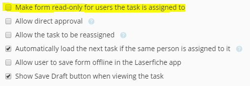

My first thought is to check whether or not your second user task has the box checked for "Make form read only for users the task is assigned to"

Thank you.  That was the problem.  The "Make form read-only for users the task is assigned to" checkbox was checked.  Un-checking it presents another issue.  The first signature does not show as being signed when the approver views it.  The other fields do show the data submitted from the original submission as expected.

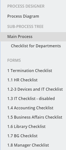

Here is what one of my processes looks like, it has multiple approval forms like Jared said. I numbered them to organize them better (1.2 and 1.3 got combined so that is why it is weird):

Thank you all for the quick help.  I didn't realize I would need a separate form for each signature, and that the field data would automatically flow from one form to the other through the variables.    I guess it makes sense to set the signature fields to read only after they are signed too.
