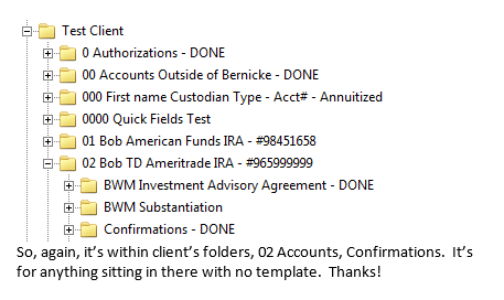

I didn't really know how to to title this, but here is what I have going on. A colleague of mine is looking to search in laserfiche for all documents that don't have a template assigned to them. The trickier part of this is that the documents have be in a certain folder. The documents in question are located in a clients "02 Account Folder", and within there, the "Confirmations" folder. Once we are looking in there, we can then search for documents without a template.
The client's folders are found in our 00 - Clients folder, and then clients are separated by the beginning letter of their last name (A - Z) within each respected client folder we then have a list of potential folders where "02 Account Folder" can be found.
I'm attaching a file for clarity as our folder structure can be confusing while explaining it. (Also posting the picture in the forum just in case someone can't see either picture)
Thanks for all the help and for those who look at this.

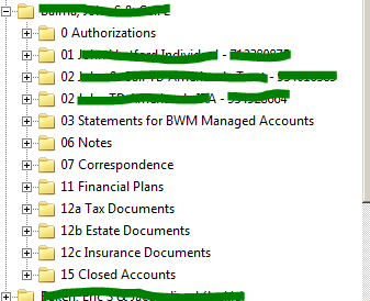

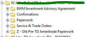

Does it matter that we only want to look within "02" folders within the "00 Client" folder? I believe right now it's looking in any folder that has a confirmations folder. So it's also pulling in "01", "03" and other folders of that nature.
so with this example. Only interested in the 02 folders. And when we go into the folder further, then we encounter the confirmations one.
