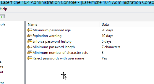

Hi,
I believe because it is one time setting no one is reporting it as a bug, but we had the same issue and get the same message and here is how to replicate it:
1) LaserFiche administration console: Have these password settings:
2) Install LaserFiche Forms 10.4.2
3) Create a named user with Manage Trustee previliage
4) User Authentication tab: You will get this error:
Failed to register the Laserfiche repository: Access denied. [9013] [LFF335-CannotRegisterLFRepo]
Variation 2 of the bug:
Give full permission and privilege for the named user or use admin user, now you will get this error instead:
Failed to register the Laserfiche repository: The password does not meet the minimum length requirement of the password policy. [9158] [LFF335-CannotRegisterLFRepo]
The noticeable that if you make the user unnamed you will get error that you must use a named user
The workaround:
Remove the password setting and all configuration page will give you no error
