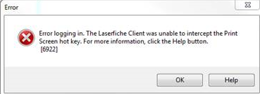

Error logging in. The Laserfiche client was unable to intercept the Print Screen hot key
asked on May 23, 2018
Hi
A user if facing this issue but only in her machine. I have followed the instructions from KB: 1013377 but no luck. That user is the only one having such a problem and there are more users in her group (without the export feature right).
Any ideas?
replied on May 23, 2018
The LF client needs to be restarted after setting the [Settings]PrintScreenIntercept attribute to No on the Everyone group. Make sure you set the attribute without a trailing space in the name.
Hi Robert, thank you for your feedback.
We have restarted LF Client several times, and I was even monitoring the processes on task manager, just to make sure only one session was created.
There are no spaces in the attribute, but I just added that to this user's windows account. But since it works on another machine, will make any difference if I also add that to the Everyone group?
Try adding it to the Everyone group. Also, if the user is a domain account linked to a LF user, try setting the attribute on the LF user too.
replied on May 24, 2018
This morning the user was able to login twice and both time LF stopped working. Now the user is getting the same error as before.
I have found out that for similar cases it was recommended to create a support ticket, but I have not found out where to do that in LF support. A little help?
Your reseller should know how to open a support case.
replied on June 27, 2018
This was solved after uninstalling and reinstalling Laserfiche Client.
