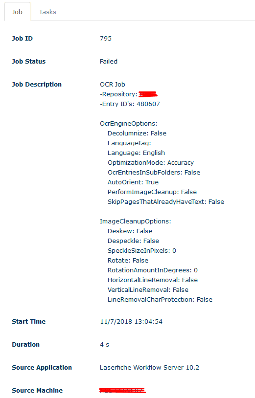

Just an FYI - I've done some more testing internally on this using the latest version of DCC 10.0.0.111 and this is also unable to OCR greyscale images, the job just fails without giving a reason. I will raise a support case:-

Does it work on that image if you turn off auto-rotate?

Hey All,
This is resolved in DCC 10.2.x, it can OCR greyscale images no problem.
