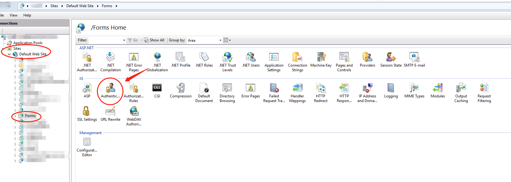

Hi Kevin,
Could you try go to IIS Manager,
1. go to Sites, then expand Default Web Site, click on Forms
2. go to right side pane of the Forms website, click on Authentication.

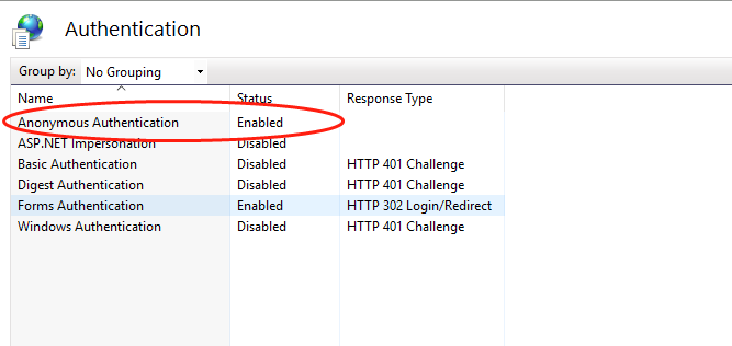

3. Could you try enable Anonymous Authentication?

I tried that. I think there was a port conflict. I have Forms working now.
