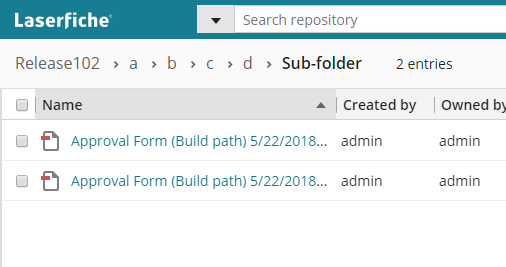

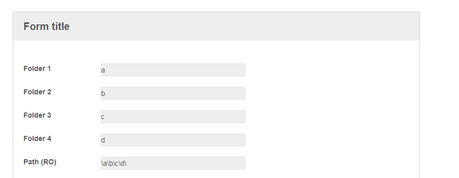

Gave this a try on 10.2.1 latest and got it to work successfully. I created the form below with single line fields for 4 folders, then used concatenate to create a folder path variable.
I used a save to repository task with the location
{/dataset/Path__RO_}\Sub-folder
and the form saved to
