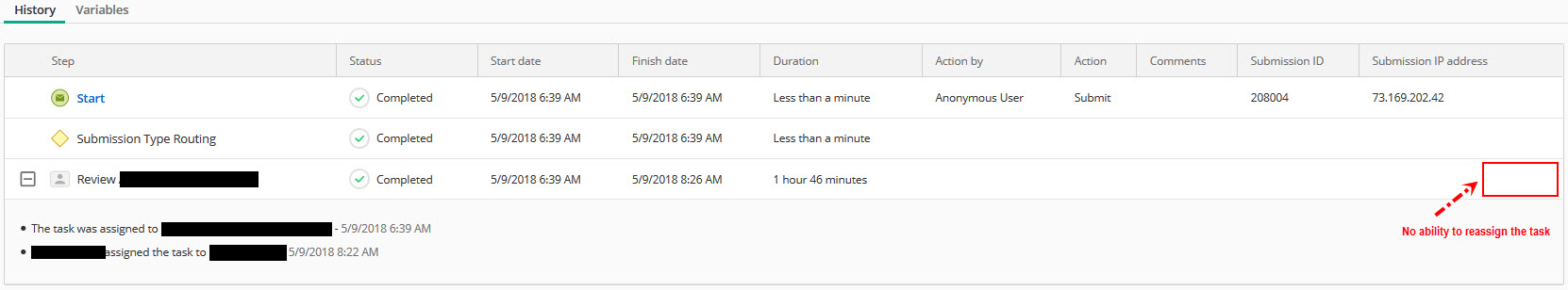

I've had several users assign a task to themselves (in one specific process), only to find that the task did not actually get assigned. When I look at the instance details, I can see the history of them assigning it to themselves, but it is not visible in their inbox. I am also unable to reassign the task.

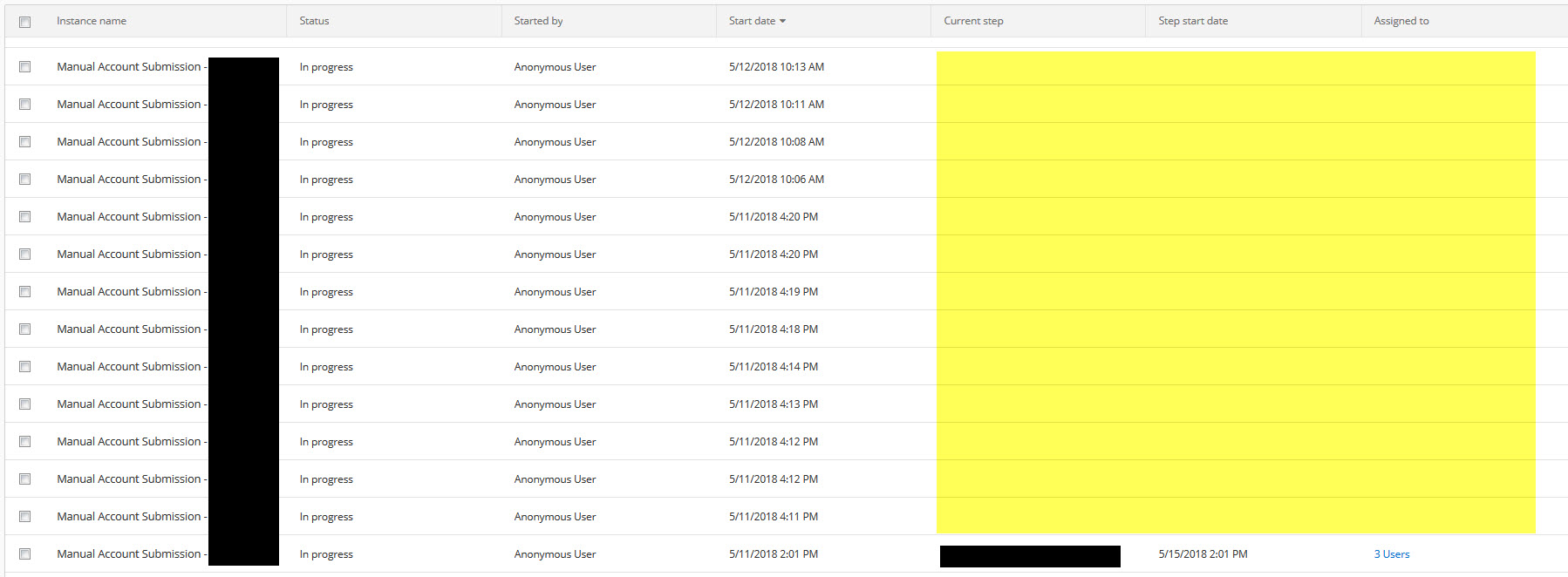

The task does show as "In Progress" and it shows that it is assigned to a user (see screenshot). When I look at the instance page for this process, the effected items show as "In Progress" but show no user assigned to them, no current step data and not step start date.

replied on May 16, 2018
It's not immediately clear what's going wrong. Can you open a support case so we can take a look at the process and investigate further?
Sure thing. Our Database Analyst is going to see if he can update the task participant from the database and if that doesn't work, I'll open a ticket.

replied on May 17, 2018
We determined what was causing this issue. It was partly a design issue and partly a user issue.
This process had 4 decision options contained in a drop down. Two of the options were for one path and two of the options were for a second path (determined by other selections made in the form). The users were selecting the wrong decision option for the path the process was.
I'll be updating this to have two distinct option fields, as opposed to trying to short cut it with one field.
