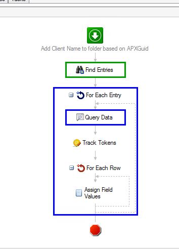

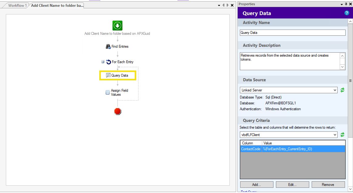

I am trying to populate a field on a template based on a SQL Table.  The unique identifier is already in a field on the template and I am trying to match up the name, using the Query Data tool.  I run the workflow and do not get errors.  The field I am trying to populate is still empty.   I reviewed a similar issue (link below) and my setup seems to be identical.  I checked for mismatches in the external table and the IDs match.

I have attached my workflow.  Any help would be appreciated.

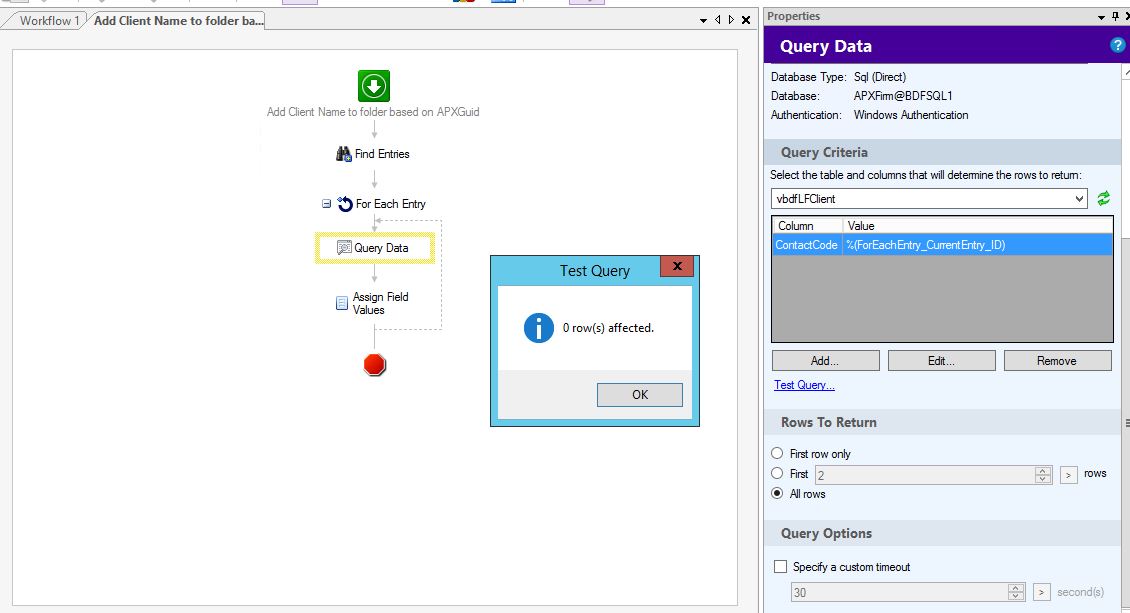

Thanks for reviewing this.  No the Query Data is returning zero results (screen shot).  I do have a token tracker, but I do not have For Each Row to iterate through the rows.  It seems like the problem is that I am not getting results on the query, at least the first problem.

If it is returning zero rows, then it is not finding anything that matches in the DB.  Look at the Query and see if it needs to be tweaked.
Also, you are using the Current Entry ID as your key field value.  Did you populate the "ContactCode" column in your source DB with the LF Entry ID?

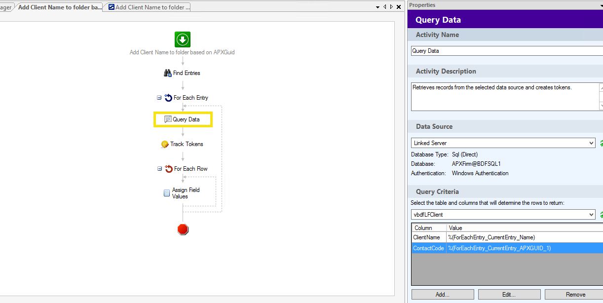

Can you post a screenshot of the configuration for your Query Data activity? That would help narrow things down a bit.
replied on May 14, 2018
Jason,
Thanks for your help on this.  Here is a screen shot of Query Data.

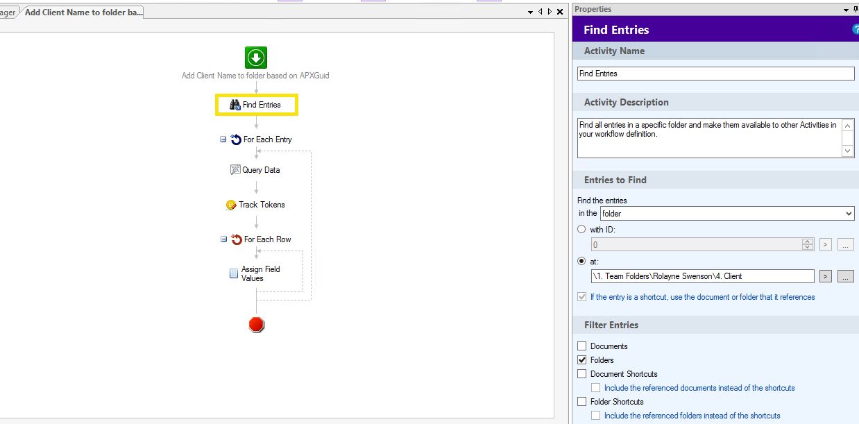

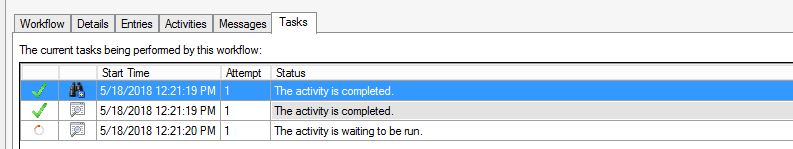

Sorry, I have to re-open this.  This workflow worked a couple times and then after more testing this stopped populating the name I was pulling from Query data.  When the workflow runs it seems to get stuck on the Query Data Activity.  I attached screen shots of the current Workflow and the errors.  Please let me know what I am doing wrong here.

replied on May 18, 2018
There is a cap on how many data queries can run simultaneously. So if you started a few of these workflows close together and they have a large number of documents to get through or if the query take a few seconds for each, it's possible that you're hitting that limit and your activity has to wait in the queue. I wouldn't worry about it in that case.
This could also happen if the server is under load.
You can press F5 to refresh the Tasks tab and if they get marked as completed, you can just ignore it.
replied on May 21, 2018
Miruna,
Thank you for your response.  I waited a day before trying the Workflow again and received the same results "The activity is waiting to run".   After waiting a while, the task still did not complete.  This took seconds when I had this working, I don't know what I did that made this WF no longer work.  I did not know about F5, so that is helpful - Rolayne
replied on May 22, 2018
Try taking a look in the Workflow Admin Console under Advanced Diagnostics\Tasks\All Tasks. It should list all tasks it currently has.
replied on May 23, 2018
Miruna,
Thank you, I have the workflow working now, I think the way I was testing was causing the issue, but your tips on troubleshooting the WF helped me realize that the WF was working correctly.  I appreciate your time on this.
