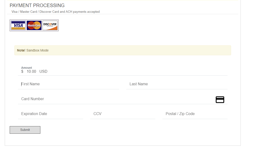

replied on May 16, 2018 Show version history
This is an issue in Forms 10.3.0 and seems to be related to having the "amount" value come from read-only calculated fields on the form.
In testing the same process from the support case in Forms 10.3.1, it flagged the other fields as being required and prevented submission.
Please upgrade to Forms 10.3.1.
*Edit* - Confirmation has been provided via the support case that upgrading to Forms 10.3.1 resolves the issue.

Hi Jared, I've attached a screenshot of the payment information with an amount due.  They were able to just hit submit and the form completed without error.  They also tested with filling out the payment information and no errors were reported.  Any ideas on why the payment portion is not required?
Thank You!
replied on May 11, 2018
Can you open a support case? It should be required.
