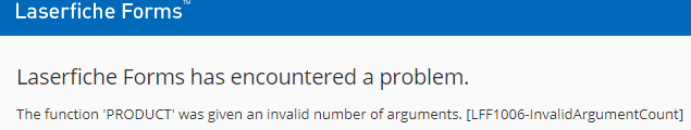

The formula below was working in Laserfiche Forms 10.2.1 in a table:
=PRODUCT(INDEX(Activity_Items.Quantity, ROW()), INDEX(Activity_Items.Unit_Price, ROW()))
However, since the upgrade to Laserfiche Forms 10.3.1 the following error is generated upon submission of the form:
Thanks,
Simon

Been working with support for a couple weeks trying to figure this one out. We are stuck on 3 major problems.
We can't seem to determine how many arguments it is expecting.
There is no indication of which field it is upset about (if you are calling the same function more than once)
Why does it prevent submitting the form, it is just a helpful calculation after all, no different than a javascript calculation.

10.3.1 and it is the same issue, the formulas existed without change but after the upgrade to 10.3.1 this problem started. We have been trying to track it down since. The real problem is that it prevents them from submitting the form and does not save what they had previously filled out. The calculations actually still work as expected.
replied on May 10, 2018
That is the same issue we are seeing. The formulas still work, but on submission the form errors out. We have three tables that have similar product formulas. We removed formulas from each table, and then added each formula back one at a time. The first two tables worked, and we were able to submit the forms in each case. However, once we added the product formula to the third table it reverted back to the initial error that we received upon submission. We tried deleting the field that holds the formula and creating a new field, but that was to no avail. We have not been able to determine why it is failing on the third table. Even after we delete the formula from the third table the first two tables that worked now fail.

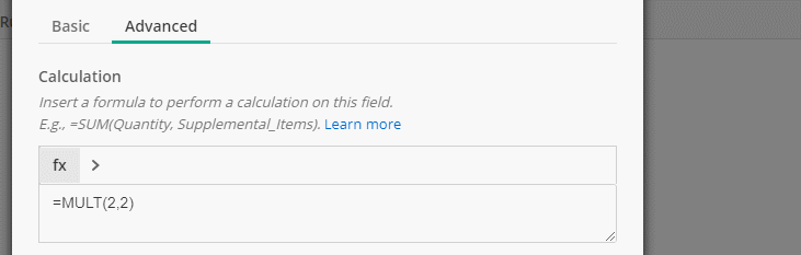

Thanks for the information! I tried the MULT function as well and had no luck with that it.
MULT is the same thing except it ONLY accepts 2 parameters. I guess it is more efficient either in speed and or garbage collection because it knows an array is not required.
I got the same error you received when I tried the MULT function.
