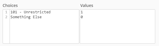

An alternate idea that may work for you, but may require you to rework the values that you use (i.e. make a 3 or a 4 be the desired value instead of a 1), is to assign values to the choices.  (I'm assuming you are using Dropdown fields)  When you assign a value, you can use a simple sum calculation instead of an if, and it will update the totals every time correctly.
Hopefully that is a route that can work if you find you are having similar issues with IF calculations.  The only slight hiccup to this idea is each choice will need a unique value.    This will come into play on the GLNum column.

While you're idea of using number values for each choice is good, it won't work in this case for a couple of reasons: 1) the combination of 3 fields is what determines whether or not the form gets routed in one direction vs another, and 2) the dropdowns are populated by a database lookup.
