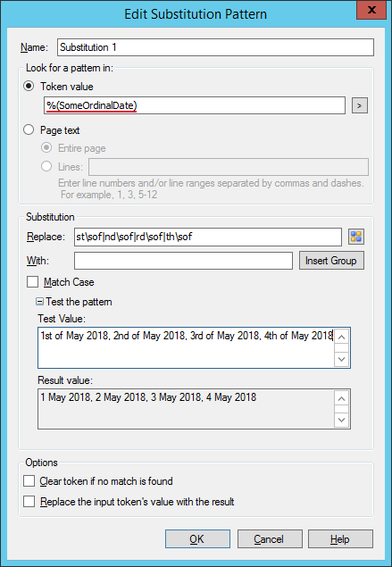

You can't parse a date in that format. However if the strings are consistent, you can do a simple modification to the strings.
Use the Substitution process on your extracted date:
Once you've run the substitution, then the date should be ok to put into a date field.

The above is good advice. Just to make it slightly more specific, for the Replace expression you might try:
(\d{1,2})st\sof|(\d{1,2})nd\sof|(\d{1,2})rd\sof|(\d{1,2})th\sof
And for the With expression: ${1}${2}${3}${4}
This will do the substitution on only the "st of", "th of", etc. only on strings that start with one or two digits, specifically. Otherwise, the phrase "heard of" would become "hea".
