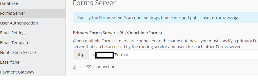

This is a madly easy question, but I can't seem to figure it out. The link to access a Form in the Process Options section, the prefix portion is not modifiable. I was under the impression it took the primary forms server address or something from config, but that doesn't seem to be the case. Where can I go to modify that prefix? Currently it simply says localhost, but I need it to be the domain name instead.

Should be in the Forms Configuration Page under the Forms Server node:
replied on April 27, 2018
Hey Chris,
That's exactly what I thought it was. And it is, to be clear. There was another error with Forms that was preventing the change from taking place, but that is the correct answer, thank you!
