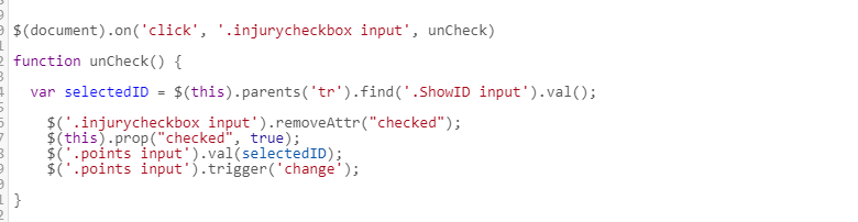

replied on May 7, 2018 Show version history
Hi Pete, I'm not an expert either :)
This is how I did it
$(document).on('click', '.injurycheckbox input', unCheck)
function unCheck()  {
$('.injurycheckbox input').removeAttr("checked");
$(this).prop("checked", true);
var selectedID = $(this).parents('tr').find('.ShowID input').val();
$('.points input').val(selectedID);
$('.points input').trigger('change');
