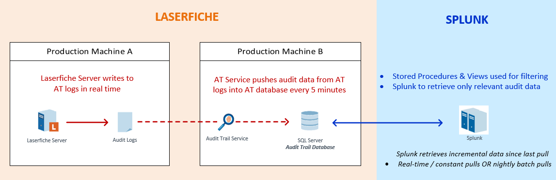

replied on April 26, 2018 • Show version history
Hi Uzair,
I'd like to share how we implemented an integration with Splunk previously - and is very much aligned with your suggested solution approach. We separated AT service & DB from LFS to balance the high auditing load, but the approach also applies for everything on the same machine.
  • Last X days configuration - control how much data is in AT DB at any given time
  • SQL Views and SPs - filter and consolidate only relevant AT data
  • Sync frequency - Splunk to retrieve incremental data at desired frequency
This can be applicable for many other 3rd party reporting / monitoring systems.
