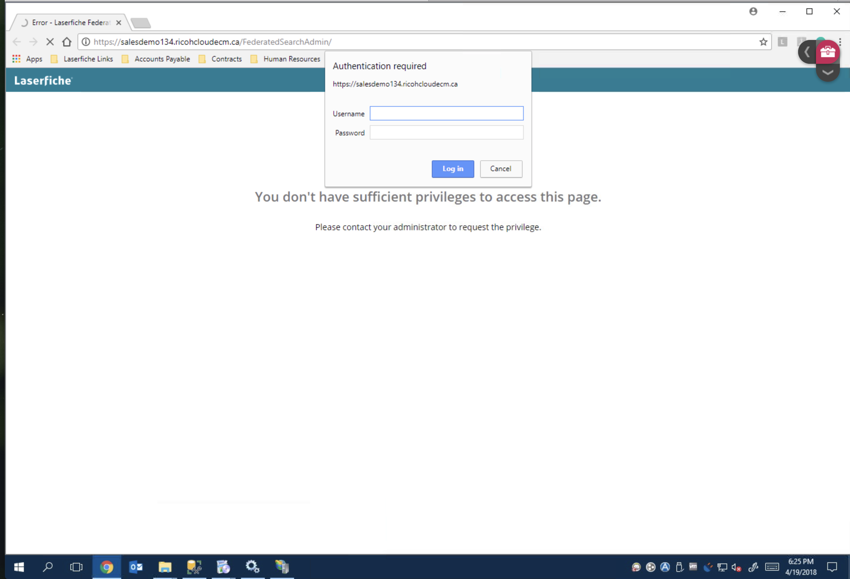

Hello,
I am trying to access the recently installed Federated Search Administration Page to configure it. This Environment is on a domain and I have configured the service account to use the domain account which is also the account I am connected to the VM with.
Unfortunately, when trying to open the application it is not allowing me to authenticate somehow the machine is not resolving to the local server perhaps? My user account has full administrative privileges on the environment and this issue is not persistent in other applications such as LFDS which are using the same domain account to run the services.

replied on September 14, 2018 Show version history
Hello Armando,
Sorry for the late reply.
We believe you've encountered a Microsoft loopback issue as https://inside/eng/helpdesk/printCaseEditor.asp?case=196457 talks about.
You can refer to https://support.microsoft.com/en-us/help/896861/you-receive-error-401-1-when-you-browse-a-web-site-that-uses-integrate for solutions, the page talks about the issue on Window server 2003  but it also happens on later os versions as we reproduced it on 2008r2 and win10. Please follow the “Workaround” part on the page and both methods should fix the problem.
Thank you I fixed the loopback issue but the application is still broken and wont let me update the configuration with the GUI.
The Loopback issue is a common problem with Laserfiche applications such as webadmin, audit trail, distributed computing cluster, web accelerator.
It will be important to have the loopback registry fix documented well or for Laserfiche to have a built in workaround to this issue.

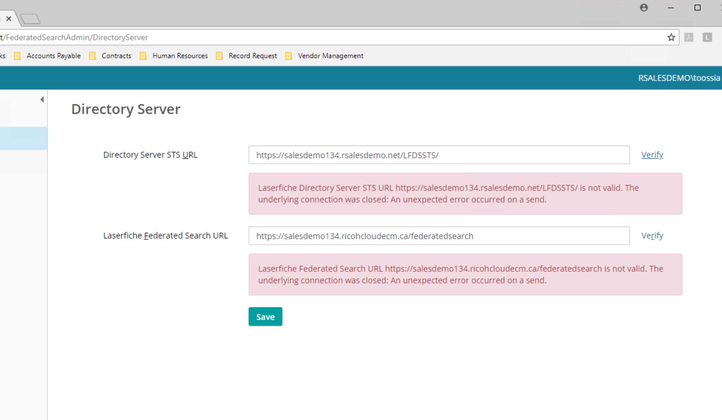

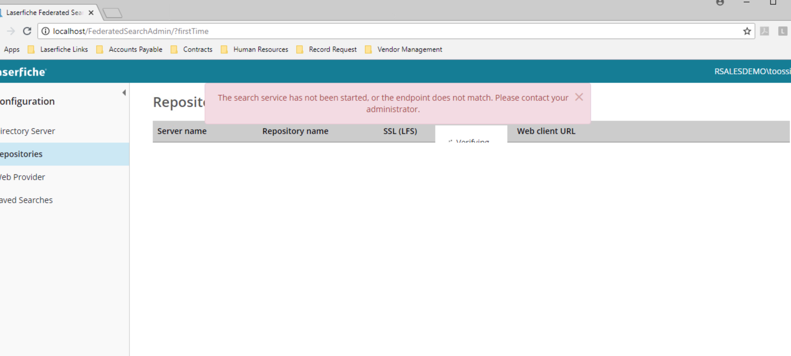

replied on September 17, 2018
Yes here are additional error screens:
Hi,
For error 1, is salesdemo134.rsalesdemo.net and salesdemo134.rsalesdemo.ca the same machine? What is the certificate you choose for FederatedSearch when install. Is it the same license server you get license from?
For error 2, please check if FederatedSearch Service started.
It would be better if you give us your FederatedSearch configuration files.(including search site web.config and app.config located at C:\Program Files\Laserfiche\FederatedSearch\SearchSite and C:\Program Files\Laserfiche\FederatedSearch\SearchService)
1. I use the same licensing server I get the license from, just like how you would install any of the other applications on the VM which do work.
2. The service is started and running as the serviceaccount.
There is no such app.config in the searchservice folder or web.config only the SearchSite has a file which is web.config. And your support site wont let me upload the file so I am going to just have to copy paste the data:

replied on September 18, 2018
It seems you did not specify certificate when install FederatedSearch.
One quick way should be uninstall it and install FederatedSearch again. During installation, there will be a step for you to provide a certificate, select the one you want and it should fix the problem.
Another fix you can choose is stop Federated Search Searvice and FederatedSearch Crawler Service, then run the following command as admin:
"C:\Program Files\Laserfiche\FederatedSearch\SearchService\ConfigurationUtility.exe" --SelectedCertHash [YourCertThumbprint]
"YourCertThumbprint" should be the thumbprint of your desired certificate.
Thanks
