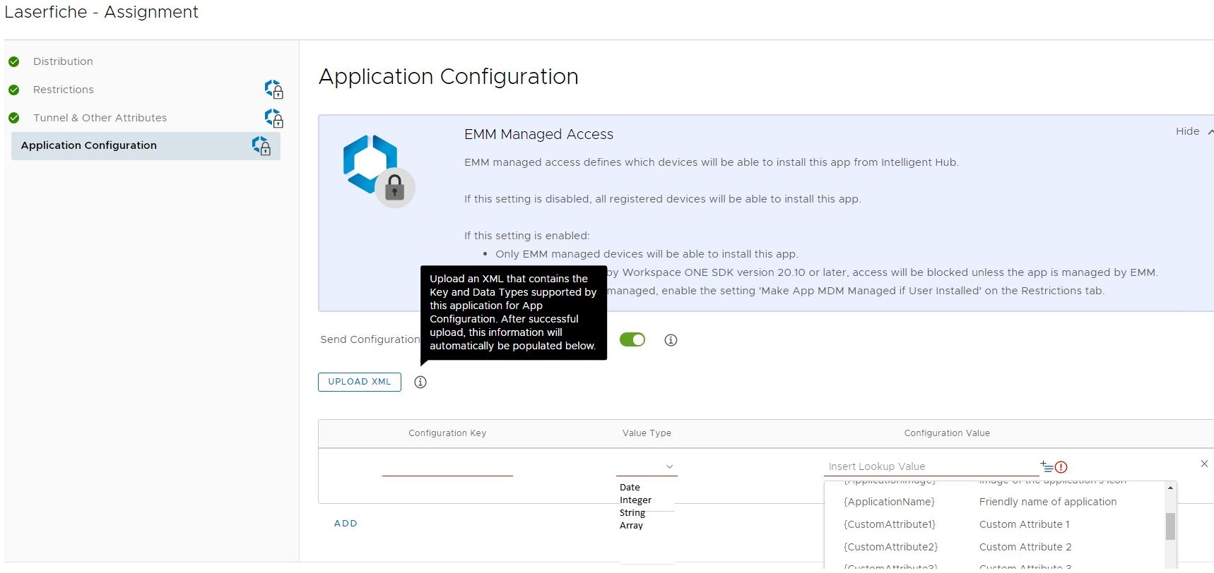

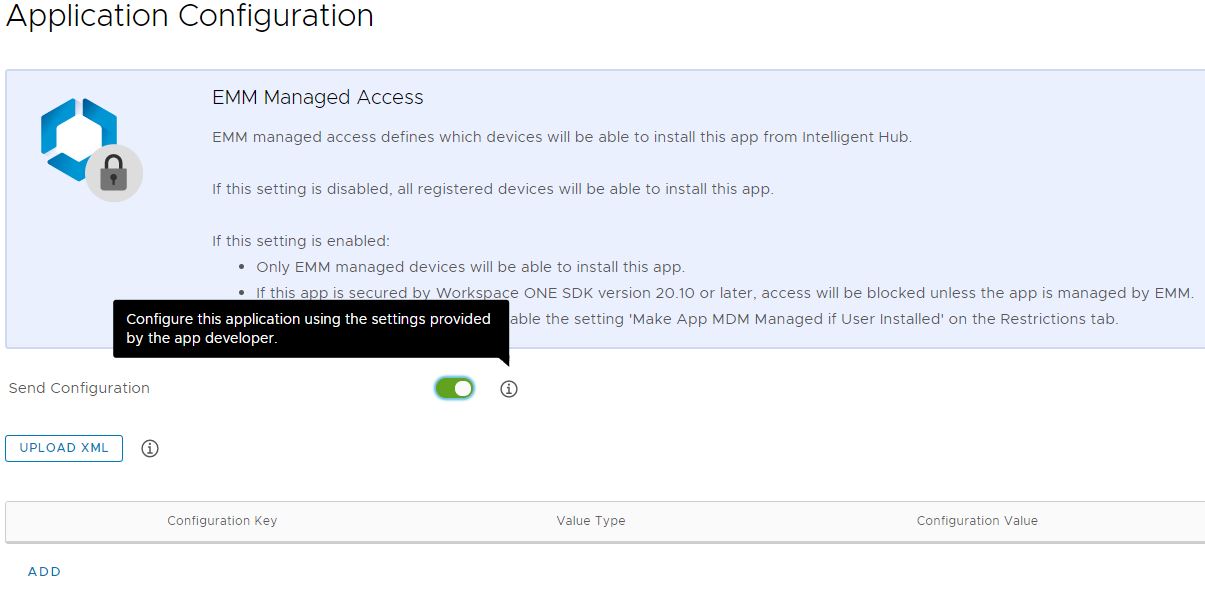

Airwatch is now Workspace ONE, but it looks like the integration mechanism is the same:
We're still waiting on any word about if this will be started/done & where it is in the Dev team's queue.

replied on January 26, 2021
That was very helpful, thank you ~
Rather than use the XML and fill out all of the fields we just used the part we wanted in the three configuration key fields below (in my previous screenshot) & then saved /assigned the app.
mobile_server_url        String          https://serveraddress/LaserfichePageName
All of our users now have the server URL filled in if they re-install the app. Once the assignment is saved. You can select the app in the app section of the MDM console (check box) --> More settings - and choose to push the configuration out the app so that they all become automatic and hide the server URL for active users of the app. (to avoid asking them to re-install).
