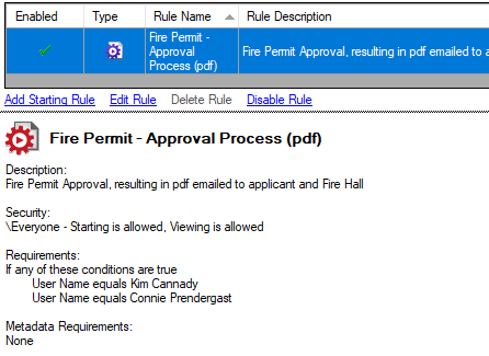

The only starting rules on the BP WF are:
