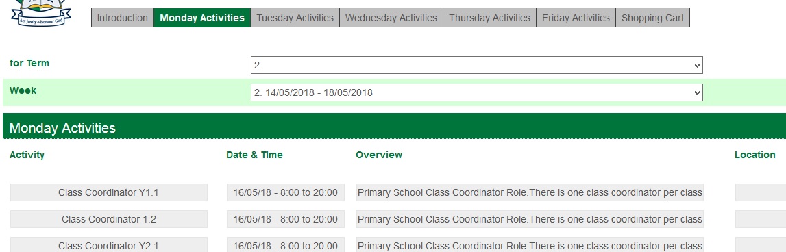

I have a table that is populated via a lookup from 2 dropdown fields (Term and Week). I want to be able to clear the table back to an empty table before the user can select another Term or Week.
I found a forum that showed how to add a Custom HTML button that reset the whole form. I was hoping I could do something similar but just the selected table?
This is the Custom HTML to reset the whole form - <input type="reset">
