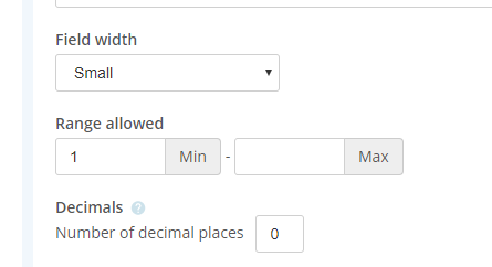

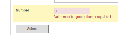

replied on April 12, 2018
Another option would be to use the out-of-the-box Range allowed feature. Just set the Range allowed to 1 min. This is assuming that you are using a Number field and not a Single Line field.
