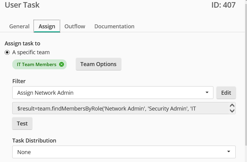

Raul, yes, using the filters as you've stated in your use case above will do what you need.  I use team filters in this way for multiple forms.  Much easier to manage by adding/removing person from the team vs. going into each form to change the assignment setting to remove Round Robin.  I think you are on right track!

replied on April 9, 2018
I wanted to follow up on what I'm trying to do and it seems that the use of Filters addresses our need, so we could have a Team called "SomeProgramTeam" in which there is a member of the Accounting group, another from Payroll and 3 from IT. By assigning a Role, when the assignment is to be set, if it only finds one member with the Role it assigns it automatically, but when it finds more than one, like in the example of the IT group, it assigns it to all 3 and whoever picks it up gets the Task.
Is this better? Am I using this correctly?
