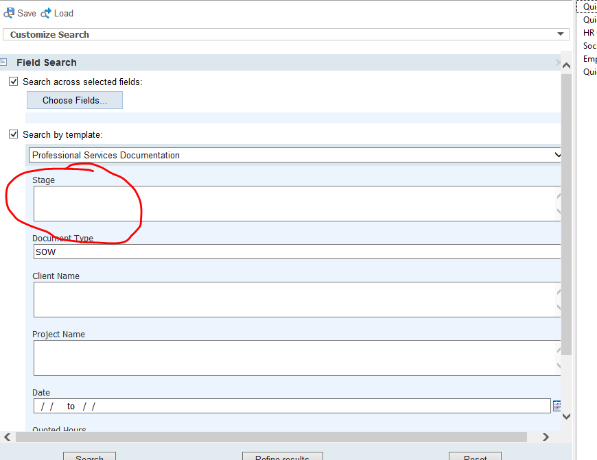

Trying to figure out the search syntax here.
1. Searching by template
2. Document Type is SOW
*3. Search for all documents with this template and doc type, where the "stage" field is NOT BLANK.
replied on April 9, 2018
You should also be able to do what you want to do by simply adding a * into the Stage field.

replied on April 13, 2018
Thank you both for the help! The operator * worked for exactly what I needed.  The search syntax was very helpful as well.
