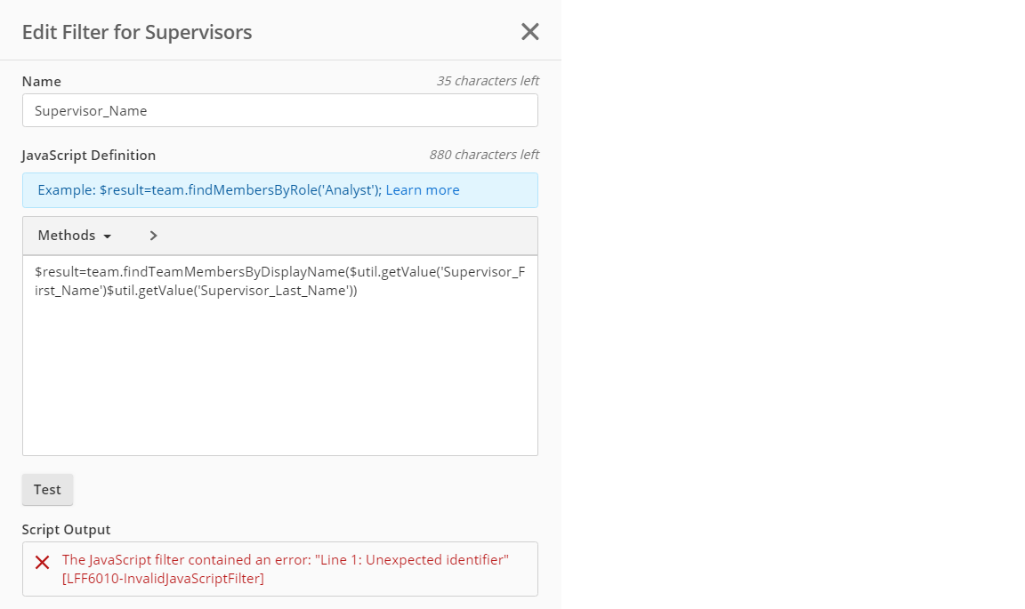

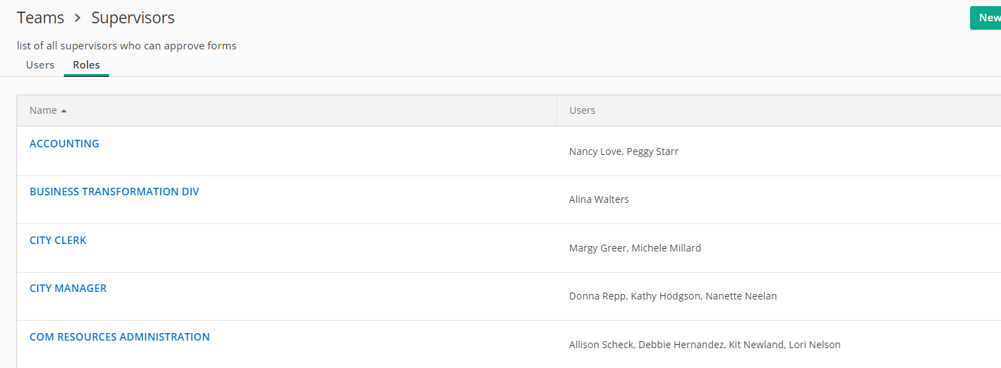

So I got the user task to be assigned to my supervisor team by role - works too well as it emails all the supervisors in the division.
They want me to send it to just 1 supervisor on the team based on the supervisor assigned to the employee entering the form.
I think I'm really close when I'm playing with the team filter of "team.findTeamMembersByDisplayName" but I keep getting a generic java script error (see attached).
attached is also a snapshot of what my supervisor team looks like.

replied on April 6, 2018
Mary,
Try it with a semicolon at the end of the statement.
Again, thanks for the feed back.
I tried with a semicolon at the end and I tried with a space between the 2 variables ($util.getValue('Supervisor_First_Name') $util.getValue('Supervisor_Last_Name')
but still get the same error.
When it worked with the team roles as the filter, it didn't need a semicolon which I thought was strange but hey - it worked!
Do you know if there's any documentation on syntax for "team.findTeamMembersByDisplayName" or "team.findTeamMembersByUserName"?

replied on April 6, 2018 • Show version history
You're right, the semicolon doesn't seem to matter, strange.  Ok I think this will work, try this:
var Supervisor_Name = $util.getValue('Supervisor_First_Name') + $util.getValue('Supervisor_Last_Name')
$result=team.findTeamMembersByDisplayName(Supervisor_Name)
When there are issues combining variables in the syntax I always just combine them into a variable first, seems to be working fine in the test box for me now this way.  In case you still can't get it to work for some reason though, here is a helpful page:
https://www.laserfiche.com/support/webhelp/Laserfiche/10/en-US/administration/#../Subsystems/Forms/Content/Inbox-And-Teams/Creating-Team-Filters.htm#tabs-2
You ROCK, Rick!! I totally owe you a coffee or something at the next empower!
That did away with the error I was getting but now it doesn't seem to be able to find my supervisor on the team so it must be something other than the java script.
Ah, it might be the space is needed between the first and last name.  Try putting the first line like this:
var Supervisor_Name = $util.getValue('Supervisor_First_Name') + " " + $util.getValue('Supervisor_Last_Name')
WHOOO HOOO!!! OMG!! that totally worked!!
