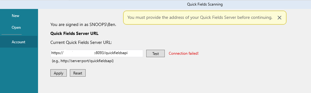

Ben, can we have a printscreen from your laptop when you try to connect to the server?

Ben, is it possible you can't connect to the server because of your server and not your laptop?
I means, do you have restriction from your server?
From your picture, the port is 8093 but from your text, the port is 8085. Can you confirm the port is really 8093 and not 8085?

replied on April 9, 2018
Ben,
you said you checked succesfully the port 8085 (using Telnet) but from your printscreen (Quick Fields Scanning), the port is 8093. Please just confirm you used the right port for your test.
Hi Oliver,
I was playing with the port numbers. Yes, I've been using the right ports for testing.
