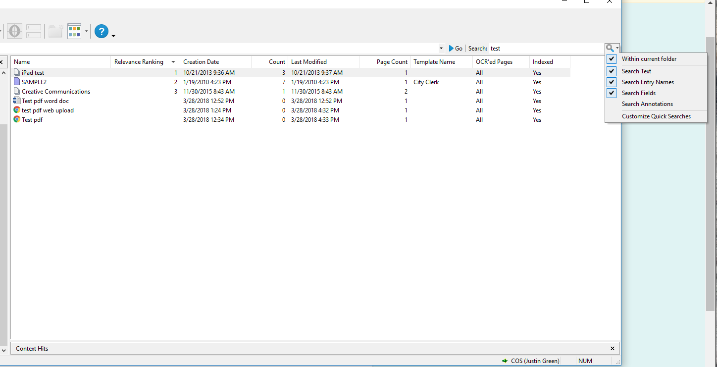

We recently noticed that new files uploaded to Laserfiche are not being searched or it seems like they are not being OCR'ed. However, Laserfiche says they are OCR'ed and Indexed but I still cannot search for text inside the document.
Example:

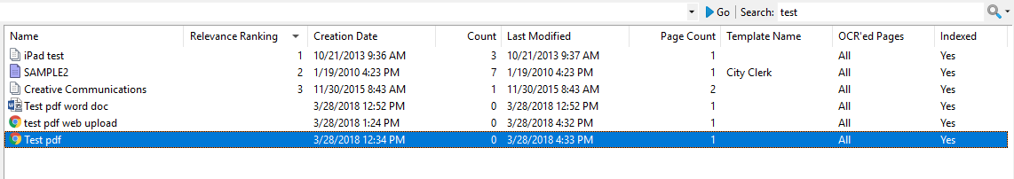

The 3 files that do not have Relevance Ratings are not having the text in the file being searched. The only reason they come up in this search result is because I searched by entry name as well as text.  I know for a fact that the word text in the files that do not have relevance ratings but Laserfiche is not seeing that.  According to laserfiche they are OCR'ed and Indexed (seen in image above).

The only way to see the test pdf file I have to have search entry names checked. If that is unchecked that pdf will not be in the results. On the pdf, I have the text "test pdf". However, it seems our search does not have the information indexed or something.

When performing text searches the top three results will show up. The results that actually have a Relevance rating show up if I uncheck "Search Entry Names".
