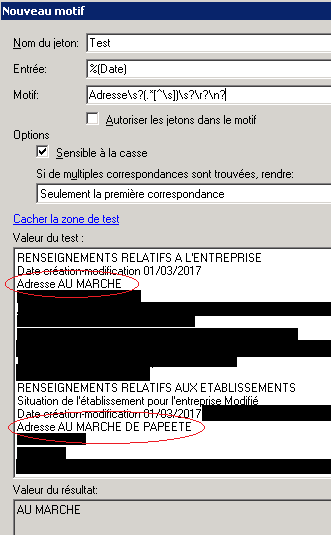

replied on April 3, 2018 • Show version history
Hi all!
I need your help about a new pattern matching's expression.
I have 2 paragraph with the same fields' name.
1. Paragraph 1
      Field 1 : value 1
      Field 2 : value 2
2. Paragraph 2
      Field 1 : value 3
      Field 2 : value 4
What can it be the expression to get Paragraph2-Field1's value?
I means, something like that : "Paragraph 2\s?\r?\n?Field 1 : (.*[^\s])\s?\r?\n?"
The expression in black is variable, sometimes I have more than 4 lines and sometimes I have only 1 line.
Thank you for your help.
Regards
Olivier
Hope this picture can help you to understand.
Do the Paragraphs always begin with RENSEIGNEMTNTS? If so, then you could use something like this:
RENSEIGNEMTNTS.*?RENSEIGNEMTNTS.*?Adresse\s*(\S.*?\S)\s*\r?\n?
replied on April 4, 2018
Hi Bert
I have 2 problems with you expression.
1°) the Paragraphs don't always start with "RENSEIGNEMENTS" but this is not really important because I can use directly "RENSEIGNEMENTS RELATIFS AUX ETABLISSEMENTS.*?Adresse\s*...."
2°) This expression don't really work because of return and line feed (\r\n)
I should write something like that :
RENSEIGNEMENTS RELATIFS AUX ETABLISSEMENTS\r\n.*\r\n.*\r\nAdresse\s(.*[^\s])\s\r\n
The position what I want is not fix.
Sometimes, what I want is in the first line, sometimes in the last line.
Example 1
Paragraph(\r\n)
     What I want(\r\n)
Example 2
Paragraph(\r\n)
     Line 1(\r\n)
     What I want(\r\n)
