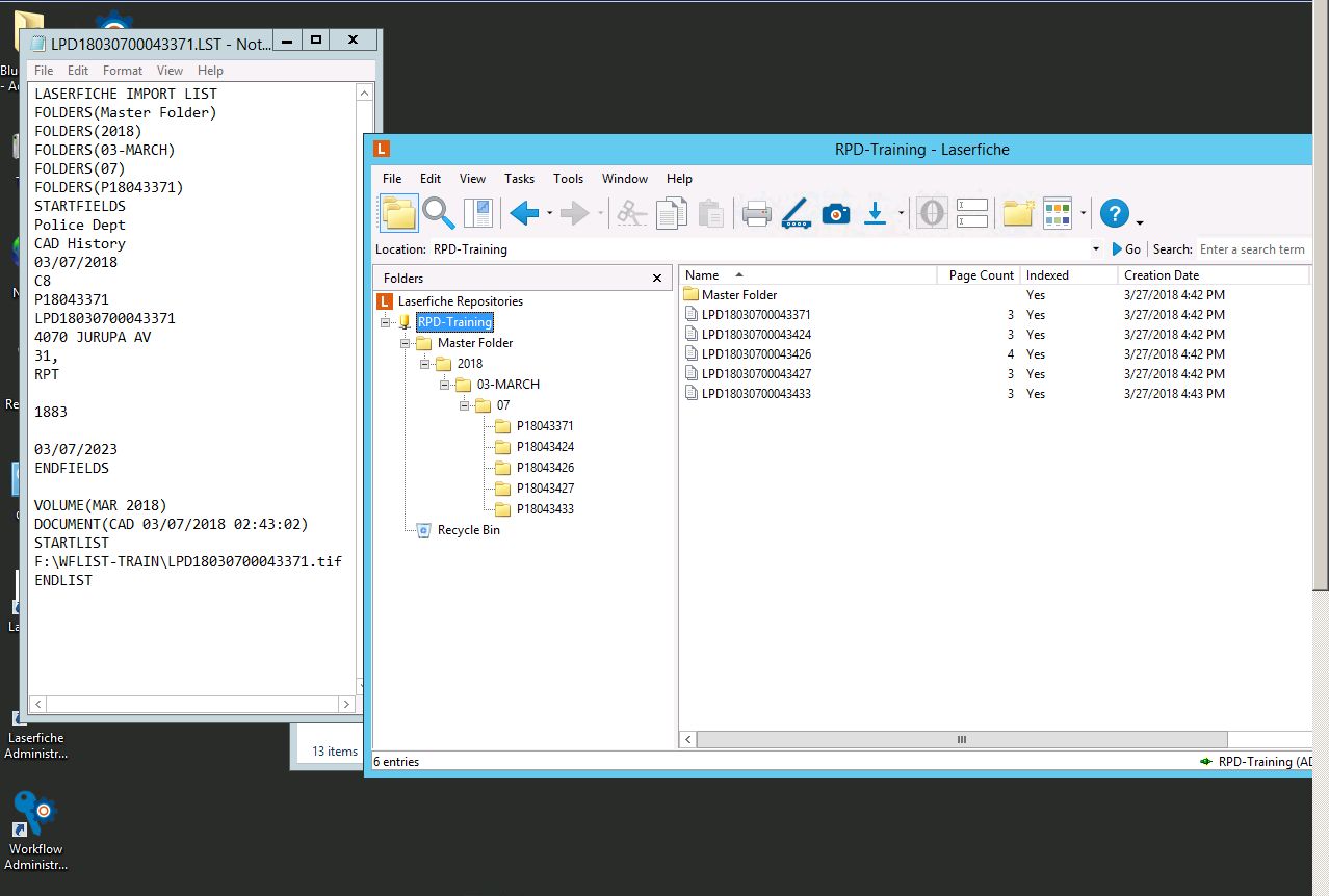

Attached is the *.lst file renamed as a *.txt file so the "Laserfiche Attach File" option below would allow an upload.

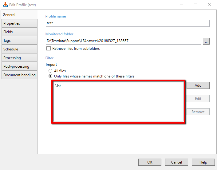

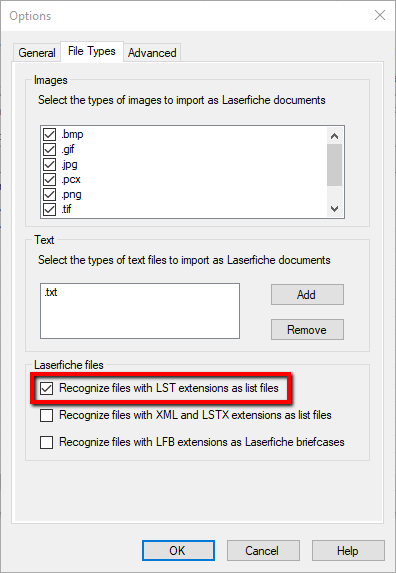

Per "Imports metadata to correct repository but does not put the "Tif" files within those entries. Instead places them under the repository folder", do you check the option 'Recognize file with LST extensions as list files' in options dialog? In lst file, the reference image is under the same folder as lst file, you should configure the filter ".lst" in the profile, that may cause the lst file could not find the image.

Already had those set
Didn't work.

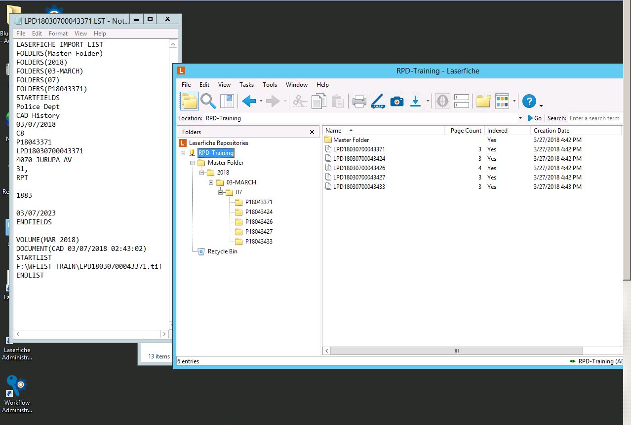

Figured out my problem.
It was the "Volume" designation.
Set .lst's "tif" location to the Volume name and not a folder in the volume, that fixed the problem.
