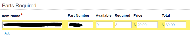

This includes the item name, part number, and the available units. The user then can specify how many are required and enter the price for a total calculation.

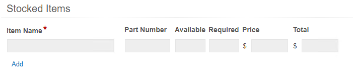

If the Available field has more than the Required, I would like the data to be pushed into a Form with a Table as Stocked Items:

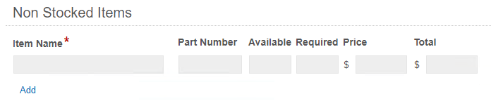

But, if any of the line items Required are not Available, I would like that data to be input into another Non-Stocked Items Forms Table as per below:

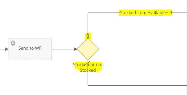

But, if one line is in stock and the other is is not, it goes to the is not in stock Inbox.

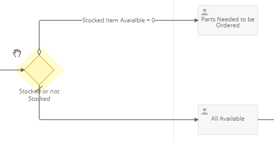

Is there some sort of trigger within the Forms you need to set? again, I have the Form Process splitting as well based on conditions?
I do not think the Form would know where to go if there is no conditions set on a gateway?

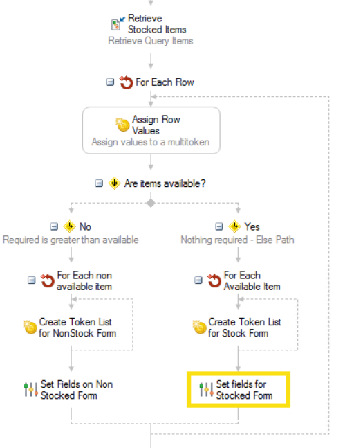

In your workflow above I see a couple issues. Your first Assign Token values should appear before the first "For each Row", otherwise the values are going to get recreated on each loop. You would not have For each Row (item) appear again under your "Yes" / "No" condition, you would just have the Modify Token Activities. Your Business Process Variable statements would only appear outside of the loops as a one time action to create the 2 forms (Stocked or Non Stocked Form) so in your Forms Process you would not have a condition as you have as you are not passing individual lines back to forms, but all of the content for that form in one shot.

The way this works is that it reads Your initial Form, Creates a set of Tokens for the Stock and None Stock Items, Reads though the table and adds the values to the appropriate Token set (Stock or Non Stock). Once all of the Rows are read, it send the information back to the form. The form for Stock and None Stock tables will then be populated with the data applicable for each. If the Stock and NonStock Tables are in separate Forms in your process, then your condition would be to choose to create a task for that form as there are items to display. If both Tables  are in your initial form then they will be updated by the process below. You will need need a condition as to your Forms workflow above.

I am trying to figure out how the Form process/conditions should look if there are different line items that are available and the ones that are not. How can I pass the information to the correct form in this process?
As in, if all or some are available = go to stocked form (only the ones that are available)
If some are not available = go to non-stocked form,
Any ideas you can throw would be awesome?

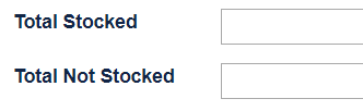

I then used this to Assign the total line items that were in stock and not in stock back into 2 fields in Forms:
With that, I also then used an Inclusive Condition as you mentioned to the above fields and assigned the values to the correct Form based on the result.
