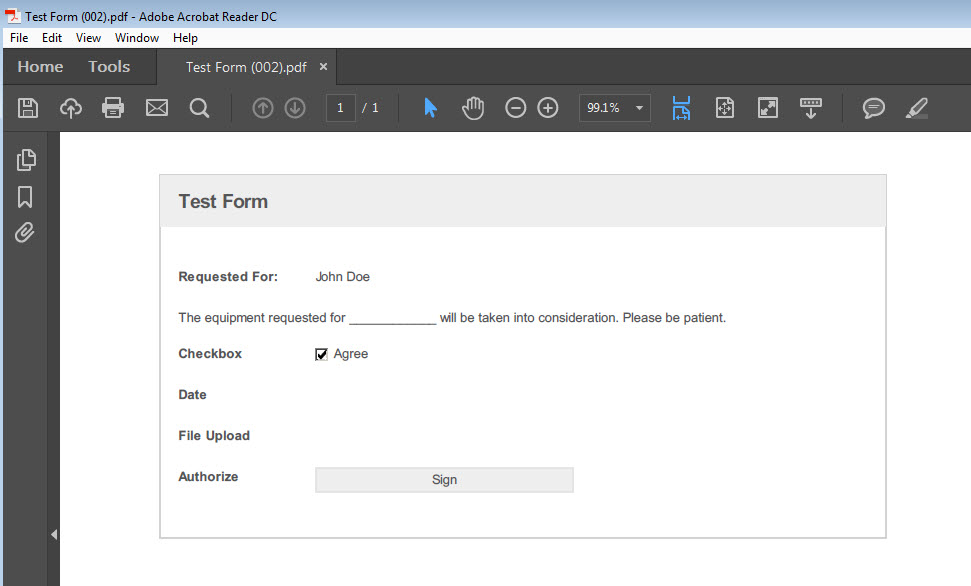

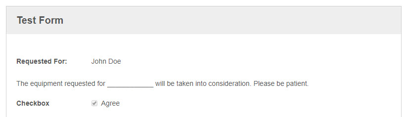

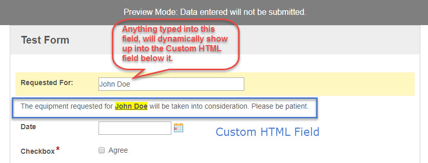

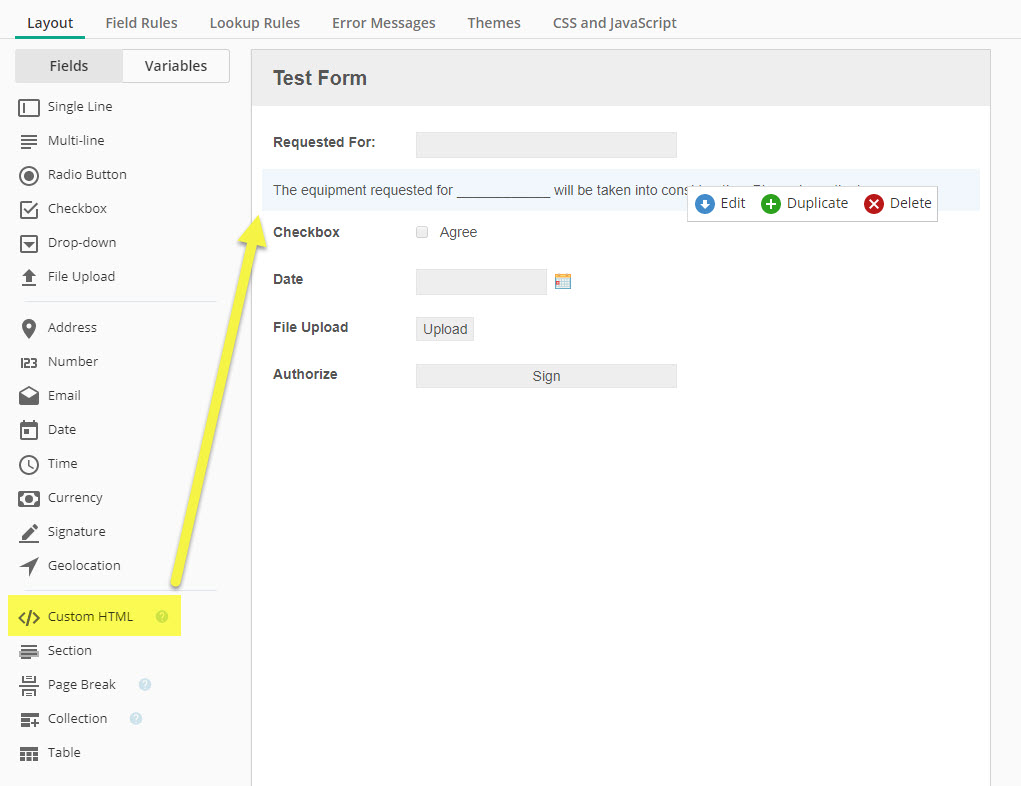

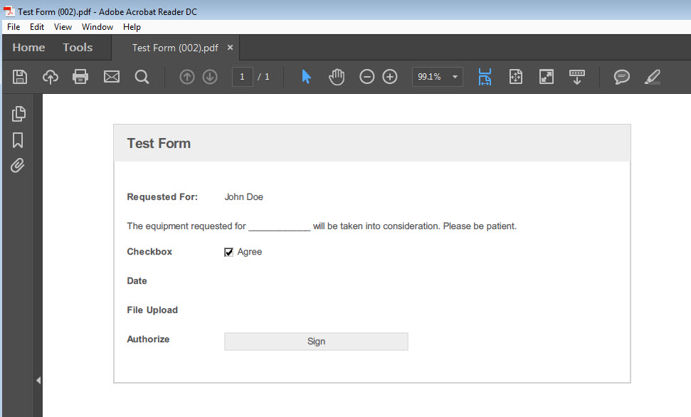

But, I don't have a good idea on how to solve this particular issue. I've created a Input box on my Test Form (see screenshots attached), and wrote some jQuery code to capture the contents of the "Requested For: " input box and dynamically write this value into the Custom HTML section.
While I am able to do what I've stated above, when the form is submitted, the changes in the Custom HTML section is not reflected on the following Thank You! page nor the Email with the PDF form attached.

The problem is that I need to grab this Name from the user (so I use a Single Line input field) and immediately after, update the CustomHTML Field as the user types into the Single Line input field above. So, to get the effect I want, I'm not sure if I can grab from a div field. I've attached a small video of what my code does currently.
In jQuery I have:
  $('#Field3').keyup(function(){
      $('#jq-req-for').html('<b><u>' + $(this).val() + '</u></b>');
      $('#jq-req-for').css("background-color", "yellow")
Then in the Custom HTML field I have the text that I want to display along with the span (with id jq-req-for) to grab this value.
Thanks again.
