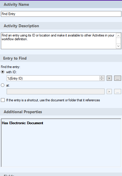

Another way to do this would be the "Has Electronic Document" property in a Find Entry activity.

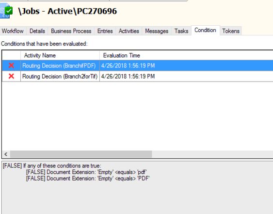

Miruna, Not sure why this is not working but when the Workflow runs no branch conditions are met.
Again I have documents in LF and I want to run a business Process on these,
if PDF run branch 1,
if TIF run Branch 2.
I used your suggestion as to conditions
if documents extension equals PDF ran branch 1  etc.
even though I have pdfs branch 1 says value brought back "Empty" (so condition not met)
I am adding a screen clip to show condition and value actually found.
Let me know if you have any suggestions.
Thanks for your kind attention.
Milton

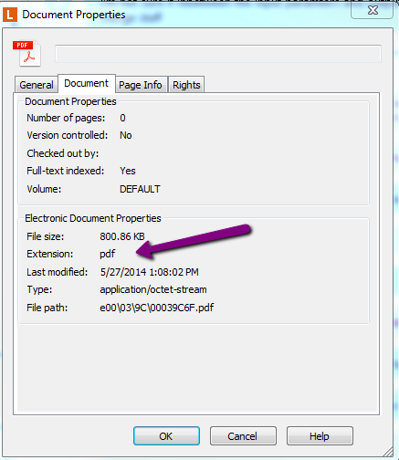

replied on April 26, 2018
Does the document display an extension if you look at its properties in the Laserfiche Client?
replied on May 3, 2018
Hi Miruna,
Thanks for the response.
My workflow creates a copy of a document that has "Extension" pdf
Then the Routing decision is working with the Copy.
So since the copy is only temporary and gets deleted as part of the workflow. I cannot check it's property. However the original document that was copied is a pdf.
 As you see from my screen shot of running workflow the routing evaluator shows "none" for the extension.
John idea below worked for me so for now my problem is solved.
But I still do not understand why result from routing evaluator was none.
