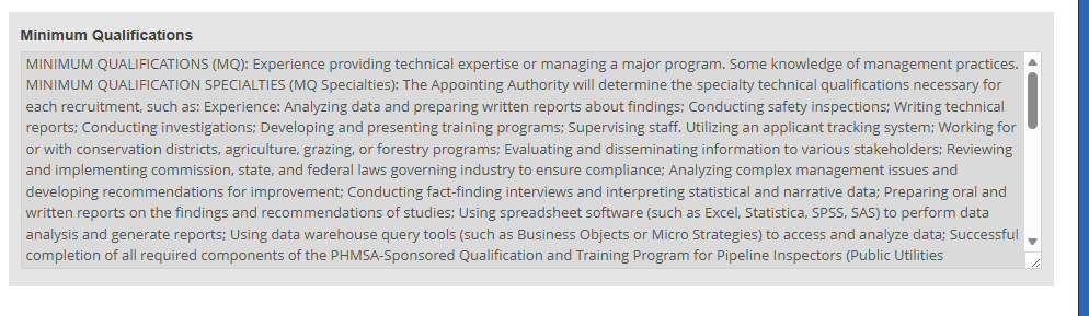

replied on September 15, 2022
When the field is read-only, with more lines than the field height, the scroll bar appears but is unusable. For example, in the screenshot below, the field height is six, with seven lines of text, but it is impossible to scroll down and see the seventh line even though the scroll bar is there.

I have a modern form with a multi-line field set to 4 lines, set to read-only.  I populate the values with a lookup that contains 10 rows.  The scrollbar appears, but is disabled.

Hello Rui, sorry for my late reply. There is no formula in the field. The current form affected by this is our yearly evaluation form that uses multiline fields as comment boxes for each evaluation section. I had to increase the multiline field's number of lines from 4 to 8 and even 12 in some sections to ensure that everything written would be visible to the person delivering the evaluation.
The scroll bar is disabled, and the user cannot manually expand or shrink the multiline field when the field is read-only. We cannot make the field editable because it is the final version that has gone through the approval process, and we do not want to risk changes done to what was already approved.

Is this broken in Forms 12.0.2503.10378?  I have a read only,  multi line text field that I'm filling with a lookup.  The vertical scroll bar appears, but is non functional. I even added the suggested CSS but it makes no difference to making the scroll bar work.

I'm using Modern Designer and there are no errors in the DevTools Console.  I'm using Edge Version 147.0.3912.60 (Official build) (64-bit)
The vertical scroll control is there but it is "frozen"

Can you try adding the custom CSS:
textarea[readonly]{pointer-events: auto !important;}
If it still doesn’t work, I would suggest opening a support ticket.
replied on April 21
That CSS made the vertical scroll bar active.  Thanks @████████
