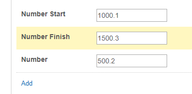

I haven't used the calculations feature a lot, so may be doing this wrong.  I am attempted to calculate the total miles driven.  The calculations are within a collection.  My formula is =SUB(MileageDetails.At_Finish,MileageDetails.At_Start).  I keep getting an error, "This field contains a calculation error.  References: At Finish, At Start."  Can someone tell me what I am doing wrong?

Or you could try something like this
=SUB(INDEX(MileageDetails.At_Finish,row()),INDEX(MileageDetails.At_Start,row()))
This is taking the finish value at that row of the collection and subtracting it by the start value at that row of the collection. The total mileage will be calculated separately at each row. Then you could sum them all up outside of the collection to get the total mileage of all trips.

replied on March 8, 2018
Thank you Jared! That worked perfectlysmiley
