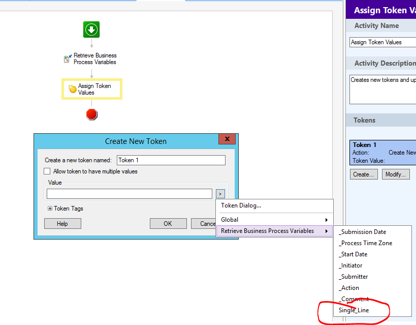

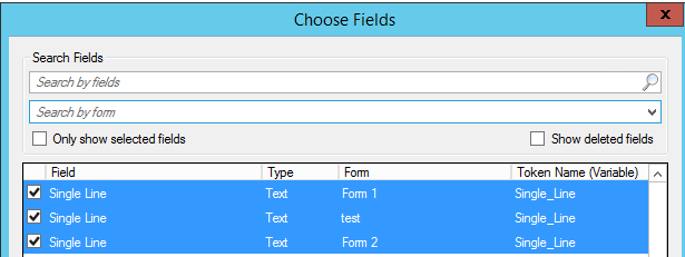

replied on March 8, 2018 Show version history
Yes. Unless you are doing something different after you retrieve the variable, using the same variable should work, no matter the form submitted.
This works:
Notice that there are three forms with the same variable, but the token only shows you one. That's because the value of the variable is always the same "last submitted value"
