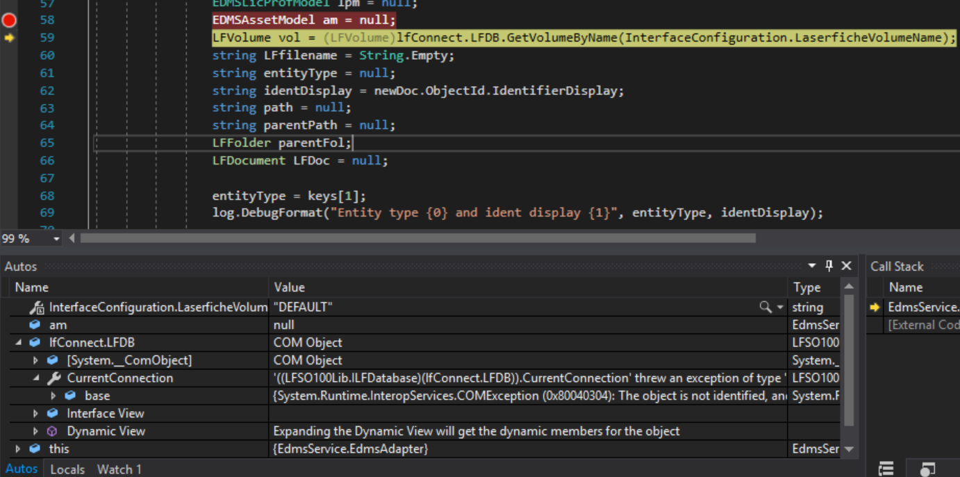

Trying to connect to Laserfiche with my app, but I am receiving the following error. What could be causing it?
Could it be configuration?
+        base    {System.Runtime.InteropServices.COMException (0x80040304): The object is not identified, and cannot be locked or read from.
   at LFSO100Lib.ILFDatabase.get_CurrentConnection()}    System.Runtime.InteropServices.ExternalException {System.Runtime.InteropServices.COMException}

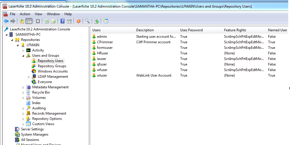

The credentials you should be using for the connection object are actual Laserfiche user credentials.  i.e one of the user accounts that is created within the Admin Console.

Can you share your code?  (At least the portion where you are opening up a connection)
replied on March 5, 2018
I've attached an image of the code where the issue occurs and the errors below opened up. It is the highlighted line that fails.
So in the line that is failing you are trying to create a reference to the LfVolume but have the LfConnection and LfDatabase been properly instantiated?  Here is a code snippet from the LFSO documentation;

Once the LfDatabase is properly instantiated and connected then you can get a reference to the LfVolume with this code;
LfVolume vol =  db.GetVolumeByName("myVolumeName");

BTW - The credentials that you need to supply to the LfConnection object are  Laserfiche user credentials not SQL credentials.  For testing purposes you could use the same credentials that you use to open the Administration Console

I'll try out setting up a test app. The inner exception appears to be the exact same thing. So the credentials should be the same credentials that I use to get my license key?

After doing some digging I first discover the COM Exception as the LFDB is being created:
+        CurrentConnection    '((LFSO100Lib.ILFDatabase)(LFDB)).CurrentConnection' threw an exception of type 'System.Runtime.InteropServices.COMException'    LFSO100Lib.LFConnection {System.Runtime.InteropServices.COMException}

My thought would be to try a new simple console application to make sure that the COM objects are properly installed and available to your development environment.  Just to see if you can connect to a repository and perhaps create a new document.  That should only take about a dozen or so lines of code...
replied on March 6, 2018
This helped me. I was using the wrong credentials this entire time. Thank you so much!
